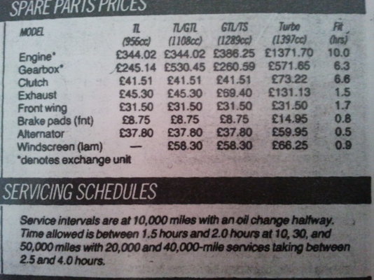

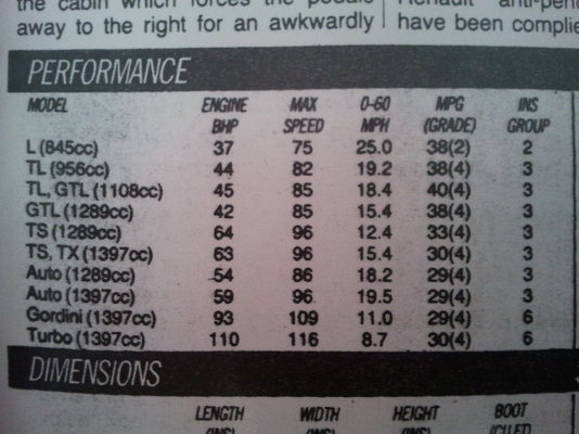

Haven't a clue what tests, if any, produced these figures but at least you can make a comparison between the versions. Check out the spare parts prices from 1984. If only they were true today!

some food for thoughts there Simon-I'm not Overly concerned by the somewhat lower mpg-figures as the Roffmobile is only in use in the summer and he's allowed a few extra drinks !! The other figures is of more interest to me -dare I say? -R.
