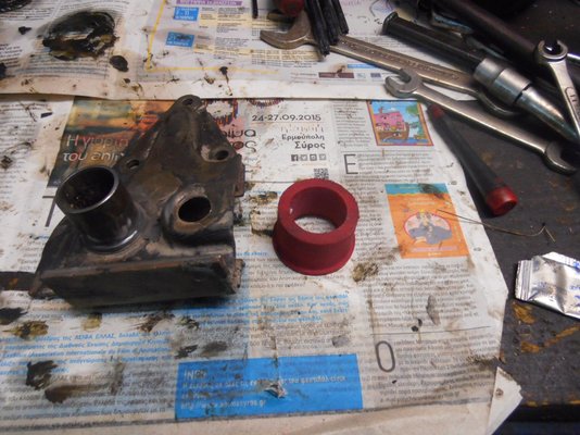

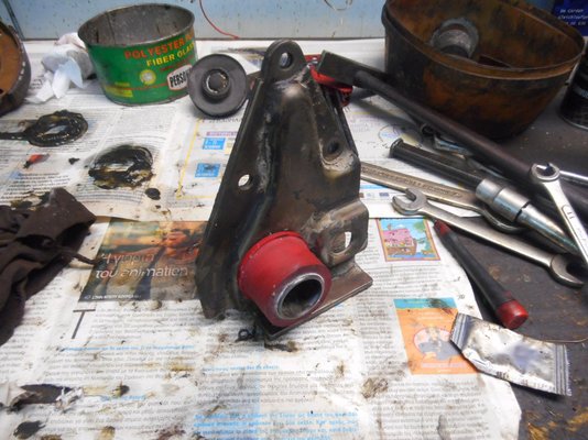

I am currently testing polyurethane inner arm bushes-installed them on a friend's R4 without telling her too much about them :-D . Results are brilliant, but it's still too early to judge if they are a worthwhile replacement to the rubber ones. Only thing that I can say is that installation is a lot easier!DSCN0982.JPG DSCN0983.JPG
