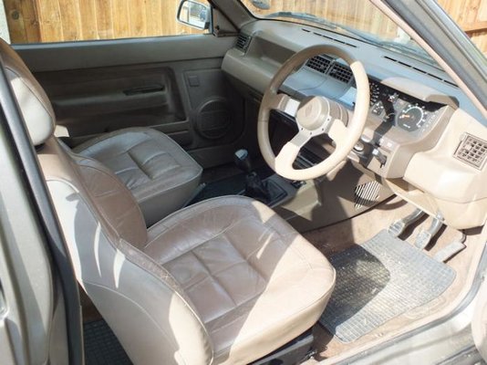

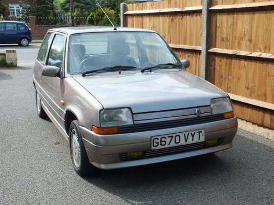

I collected a Renault 5 Monaco today to replace the Campus - it's the 1.7L engined R5 with leather seats. It's covered 38,000 miles from new. The bodywork is sound, and the interior should polish up.
Couple of big vacuum hoses were disconnected so it ran like a bag of nails when I bought it. I've pushed those back on and it's a lot better but not perfect yet. I'll need to look around for other vacuum leaks. Also I have no history of cambelt changes but if recent servicing is anything to go by it will be frighteningly overdue so that's a priority.
Should be fun. It's not quite as different from the Campus as I had expected. You sit up a bit higher in the Monaco. It's faster but not road scorching, it's quieter but not refined, and it feels like a heavier car. It just feels like a more grown up Renault 5. And it's got remote control central locking and intermittent wipers!
