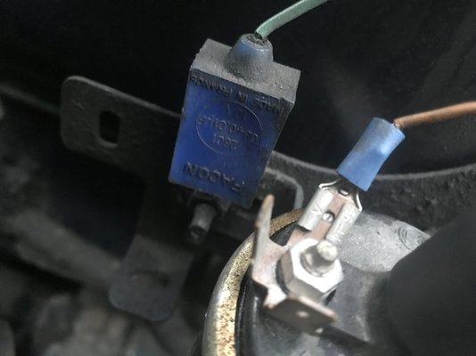

The only other trail of thought is there is a condenser wired to the coil - if this wasn’t working could this stop the firing?
Yes, it would. Although I understood the condenser to be new. Mind you, "new" doesn't always mean "good"! There's a way of testing condensers, using a multi-meter, should you need to know it.
Not the condenser in the distributor- there is a little blue box with Facon on it wired to the coil , upon research this looks to be a condenser
The condenser in the picture doesn't look in the best of health. In particular, the connection at the top looks worn. I'd replace it anyway. It should have a value of 2.7 micro-farads somewhere on it.
