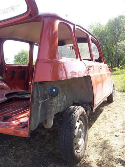

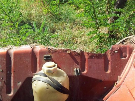

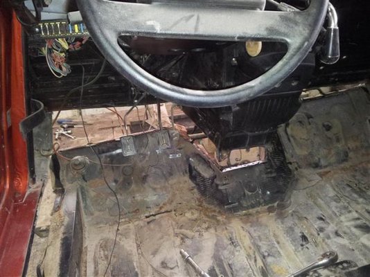

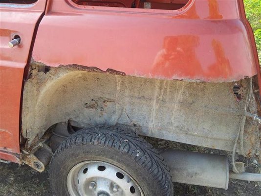

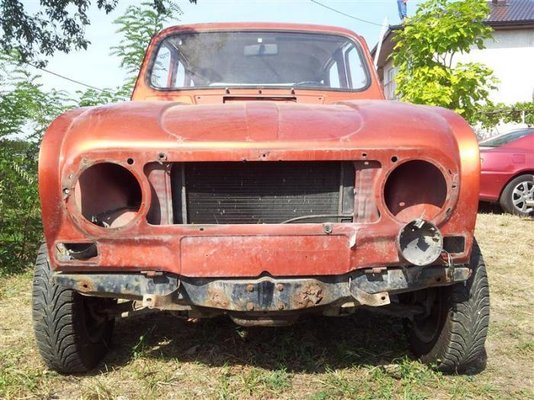

I am well into restoration of my 1988 slovenian made GTL but I haven't been talking about it on this forum. I think it is time to let you know what have I been doing for the past few months. I do hope I am not exaggerating when I say restoration. So here we go...

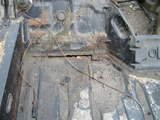

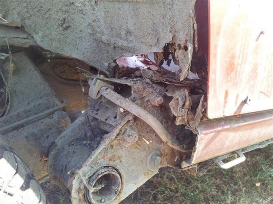

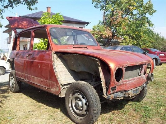

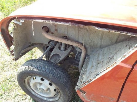

This is what I started with, the car was in bad shape, rotten all over, the chain snapped so the engine was not working etc.

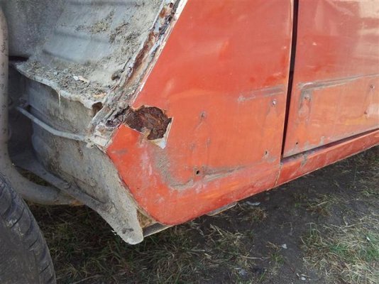

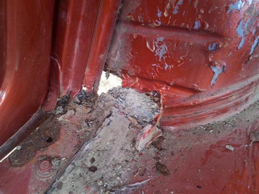

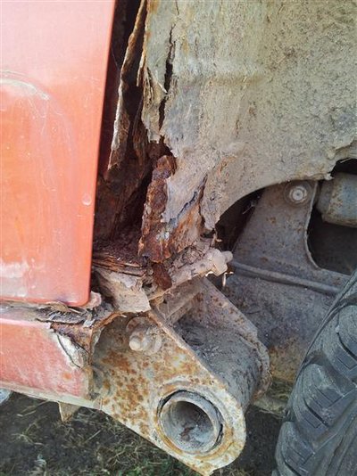

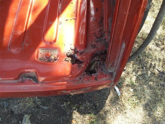

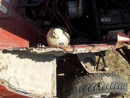

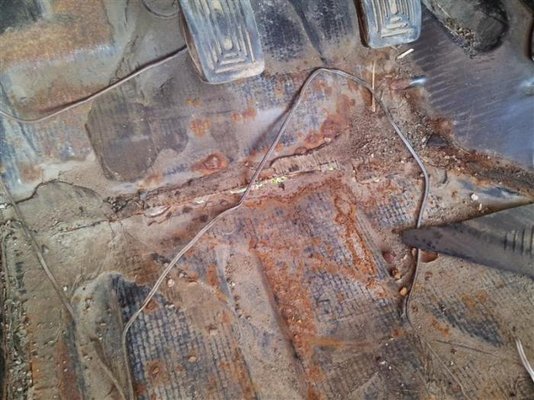

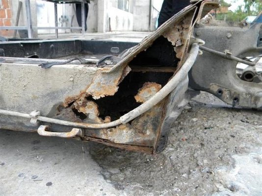

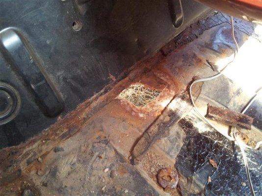

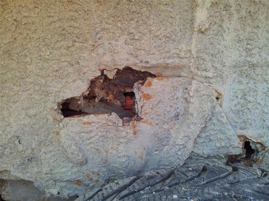

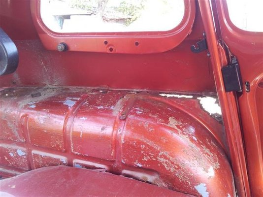

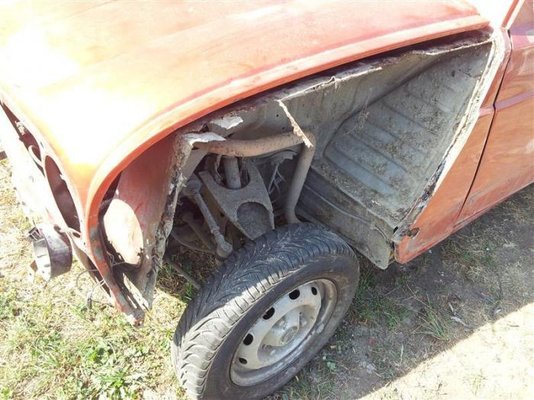

Tin worm got it really good:

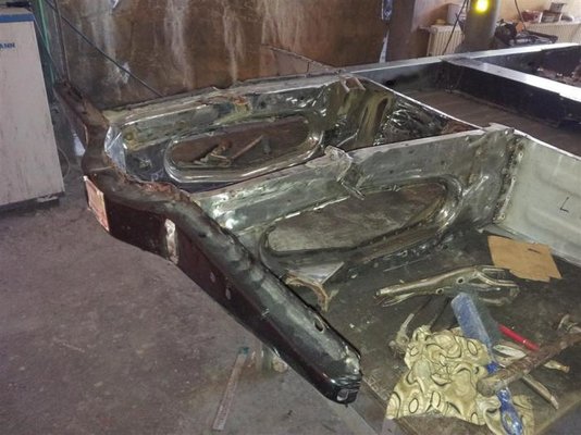

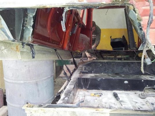

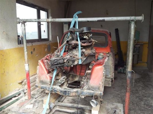

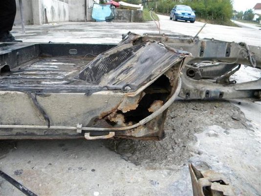

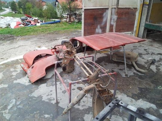

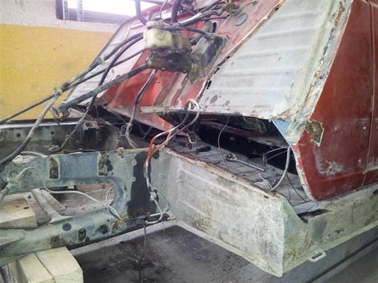

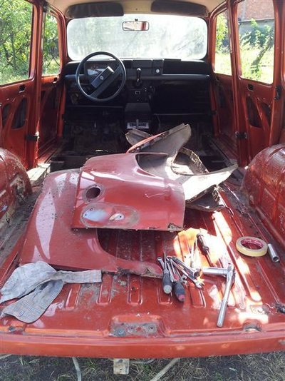

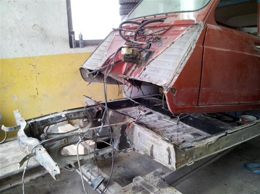

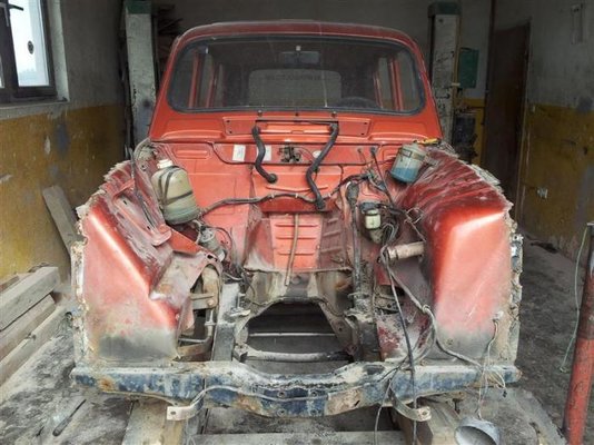

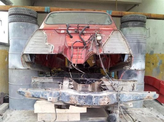

The engine is out and the body is being separated from the chassis...

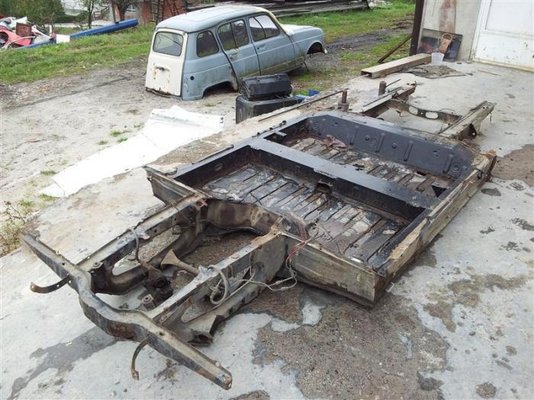

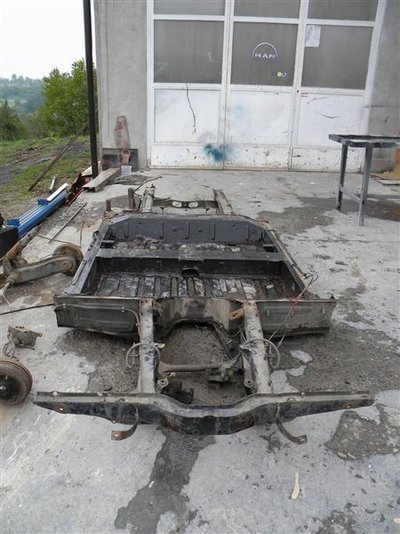

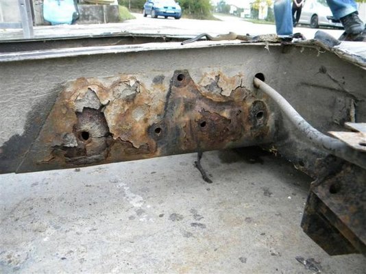

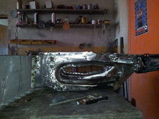

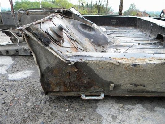

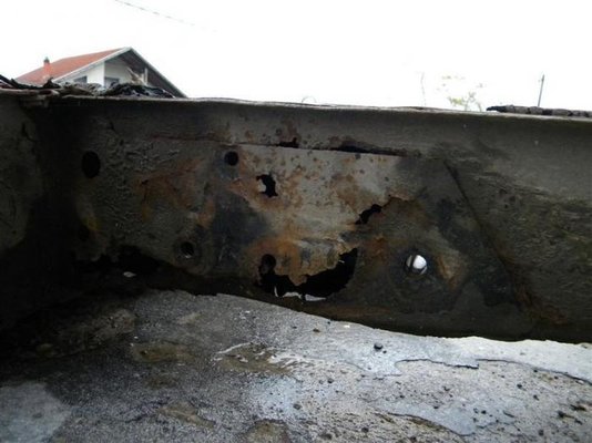

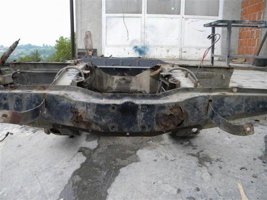

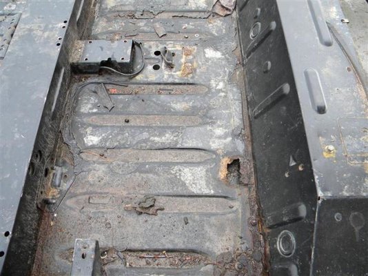

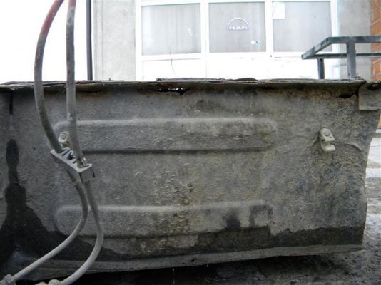

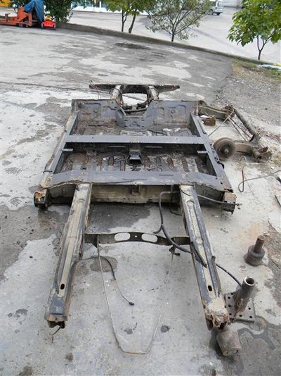

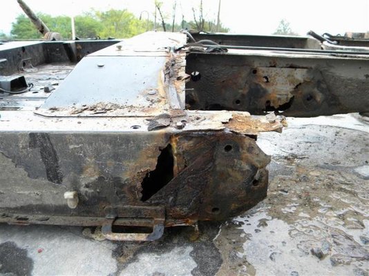

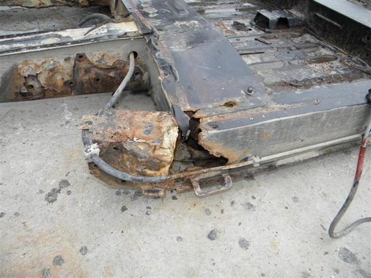

My spare R4... the body of this car will be used for the project. The chassis is rusted in all the usual places.
More photos of the chassis...

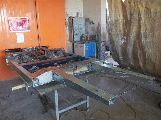

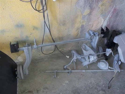

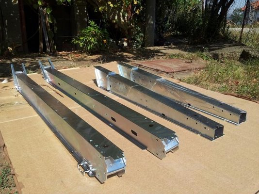

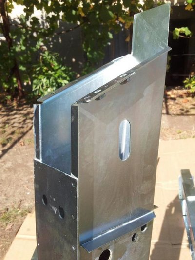

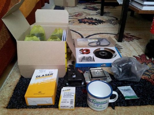

It is not that easy to get parts over here, it took me over a year to plan, find and transport everything. I've got parts all over the Europe, franzose.de, melun-retro-passion.com, from our forum member petak etc.

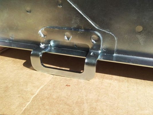

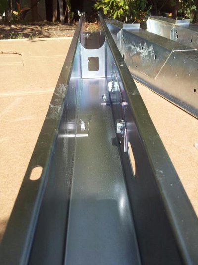

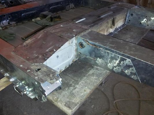

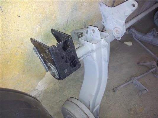

These are brand new chassis parts made by petak, after I got them I've send to be galvanized and this is what they look like.

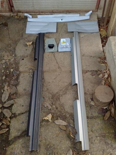

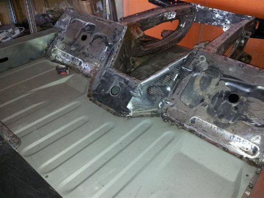

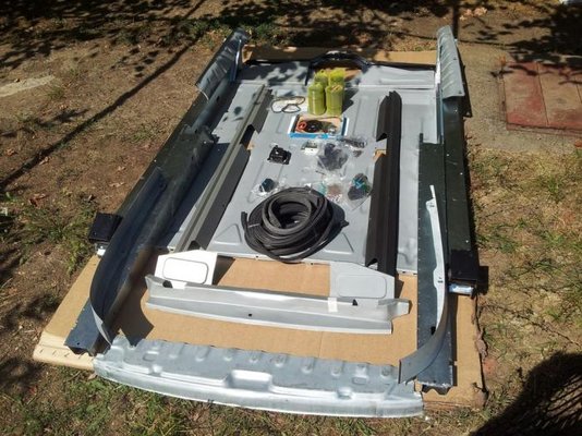

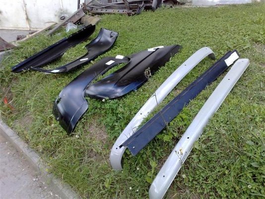

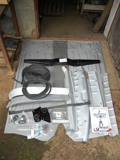

Brand new floor from France... and some chassis parts from Germany. Not to happy with those sills, at the end I haven't used them. Found one NOS and the other was OK. All the wings and bumpers are new.

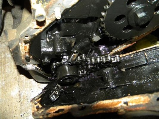

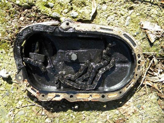

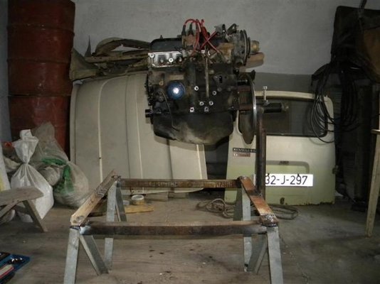

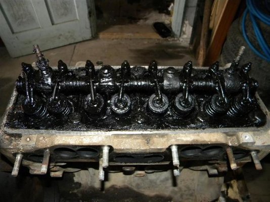

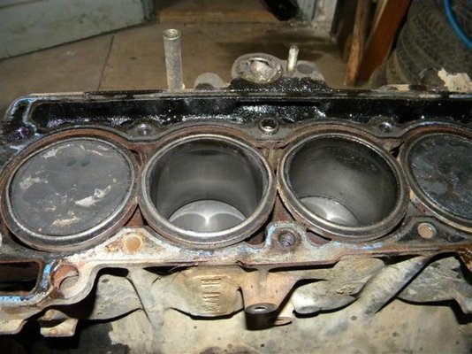

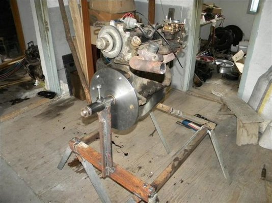

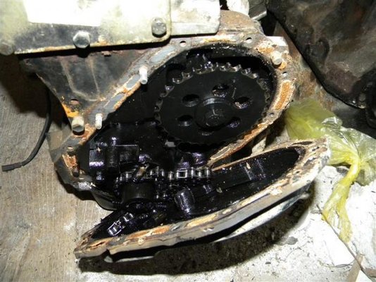

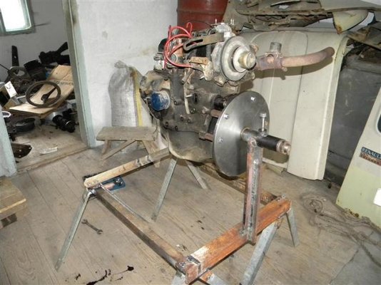

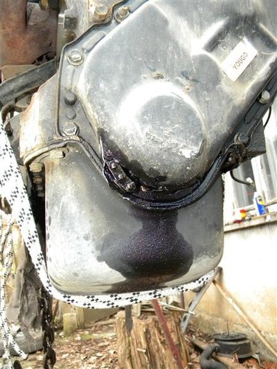

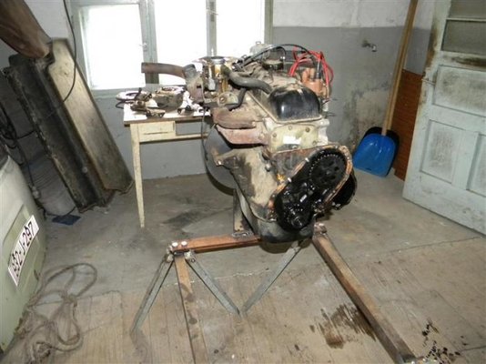

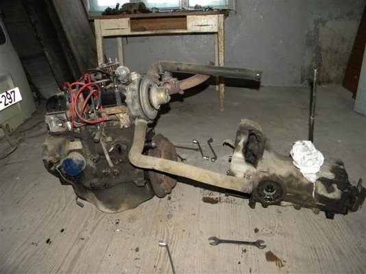

This is what happend to the engine... We got it out and started to work on it.

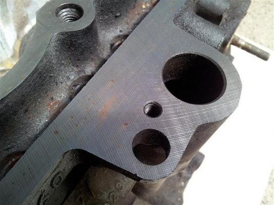

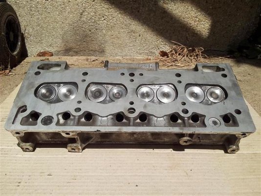

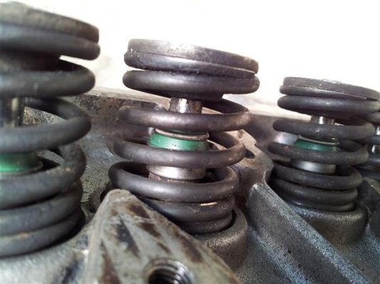

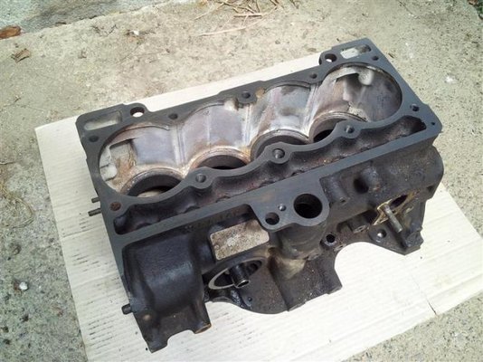

More photos and new parts for the engine. The head and the block were machined.

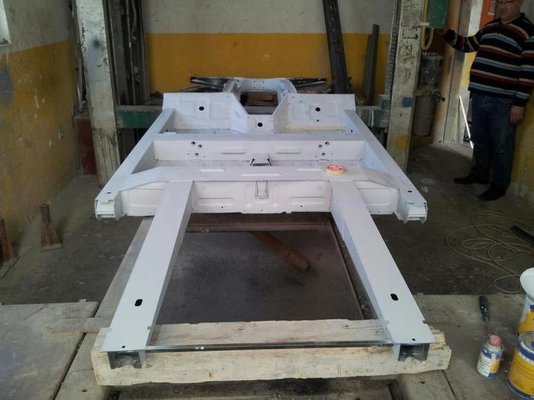

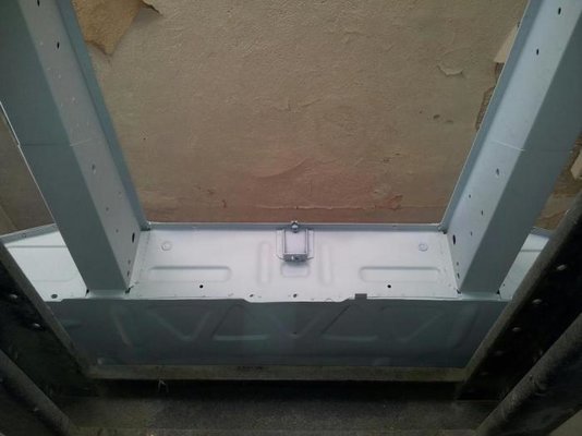

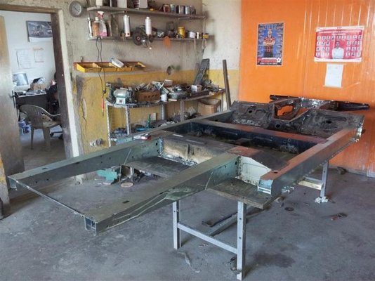

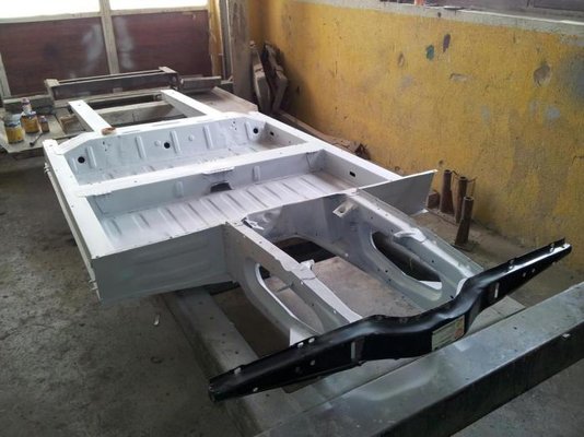

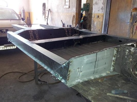

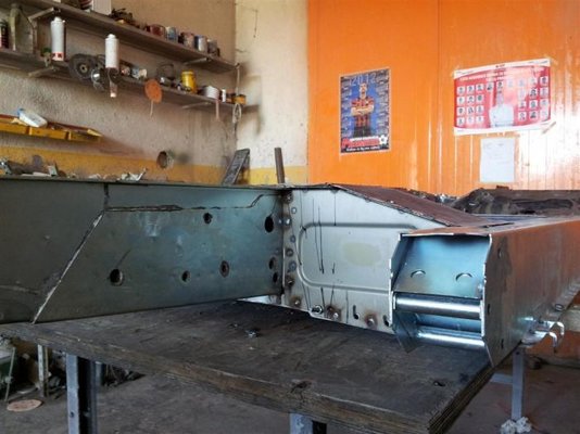

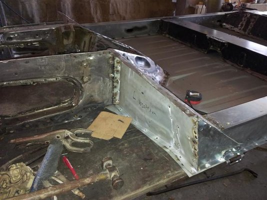

Chassis with the new parts.

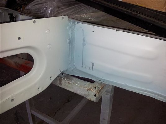

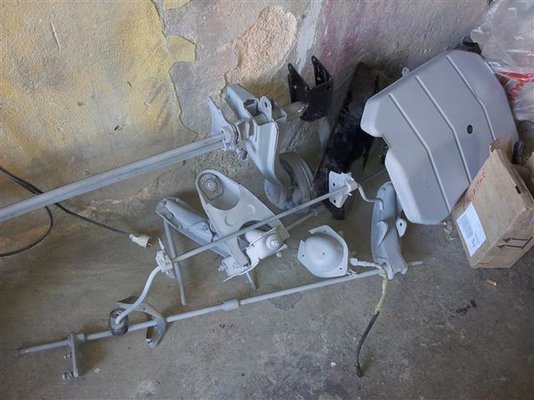

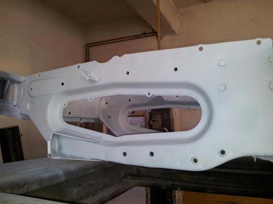

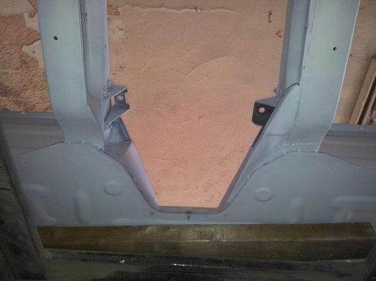

The rust and the old paint has been sand blasted. Then it was painted with wash primer.
Yet another excellent work and the story in progress. Go ahead and if you are missing some parts just ask your neighbor, maybe we can help :)

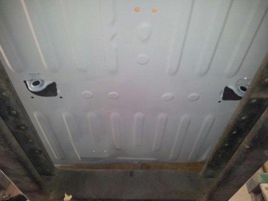

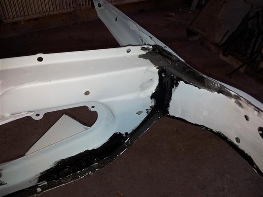

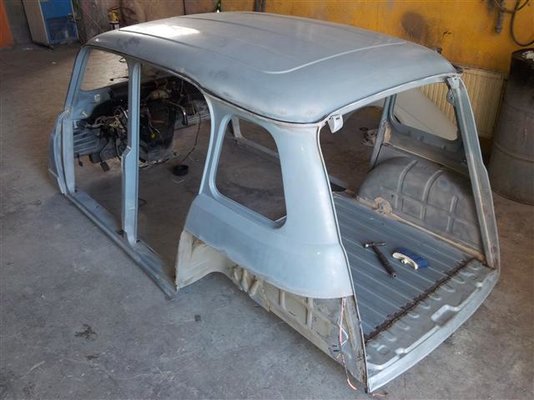

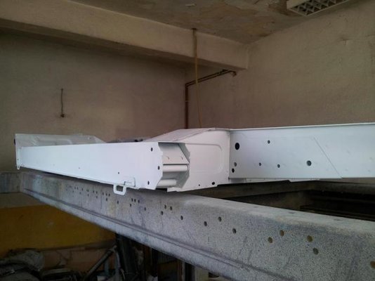

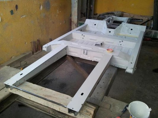

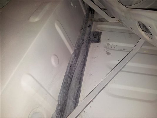

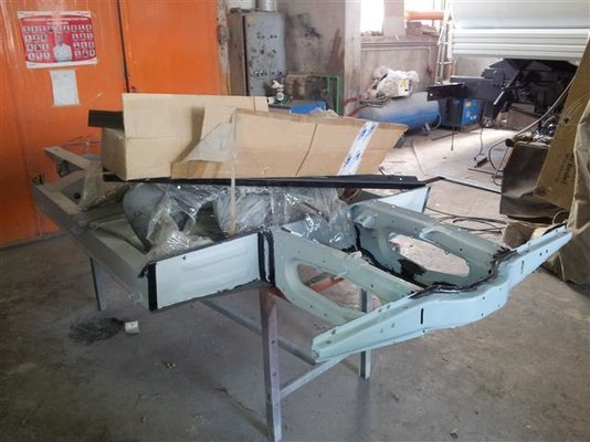

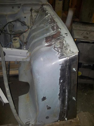

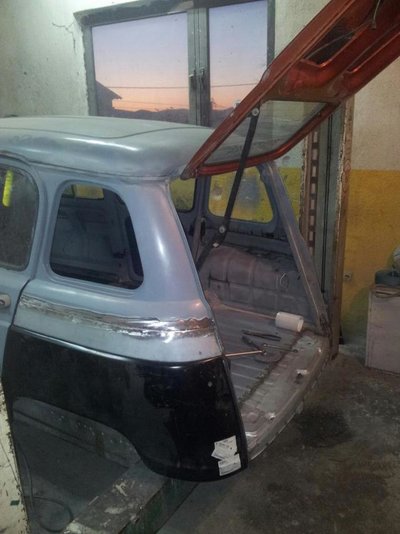

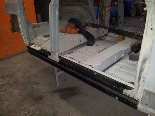

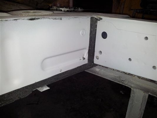

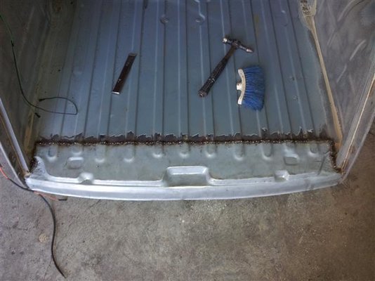

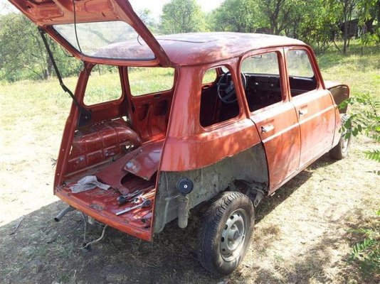

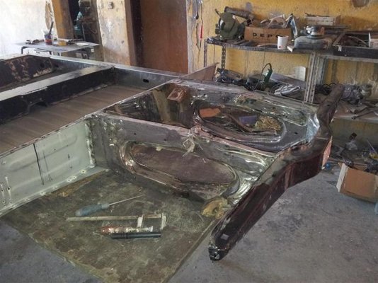

The chassis is sealed and the work on the spare body has started...

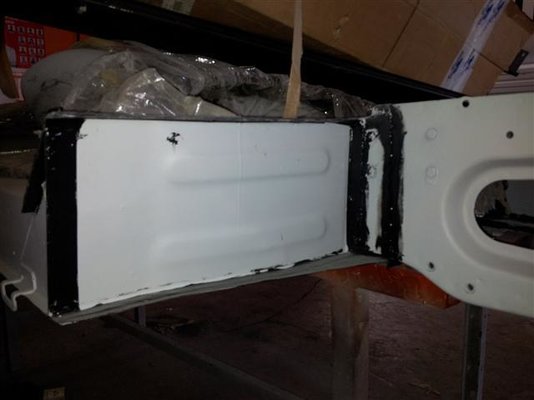

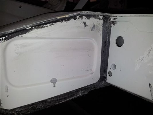

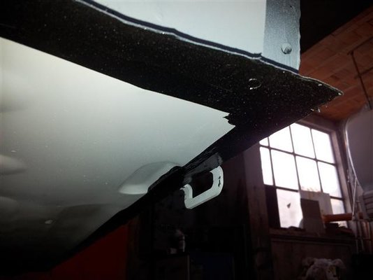

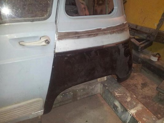

The right door sill is new, the left one was sand blasted and it was ok.
