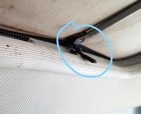

I'll have a look tomorrow and take a few snaps - it seems to be the 'tail' that you pull down over the screws that suffers from fatigue (hardly surprising after nearly 50 years..). Unfortunately I don't have one that's not on the car - will be in touch with you and Stuart (who may have a spare one).

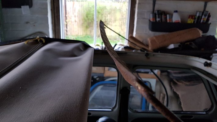

As I don't have access to an original near me I do have a question to ask anyone with one of these - the flat pieces of metal that run across the front and back (the ones that secure the moving part to the frame), do they swivel on the front and back arms? I notice there are a couple of small tabs pointing forward as well. I can't see how they would be able to clear the front edge of the frame unless the cross-bar can be swiveled slightly as it it brought down. Am I miss reading how these things operate? Any clues welcome.

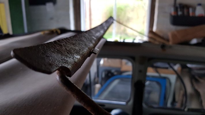

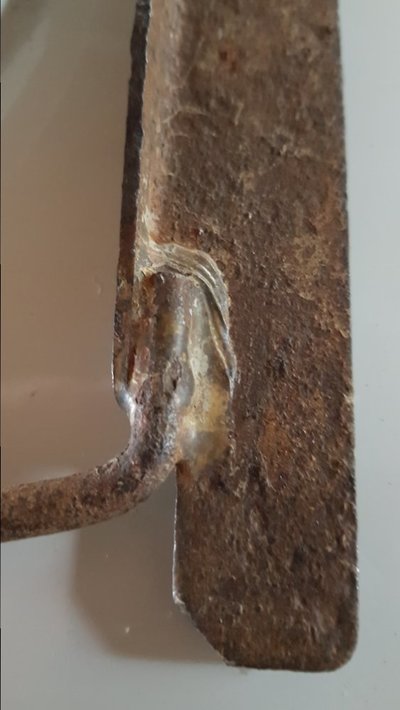

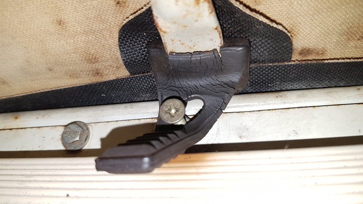

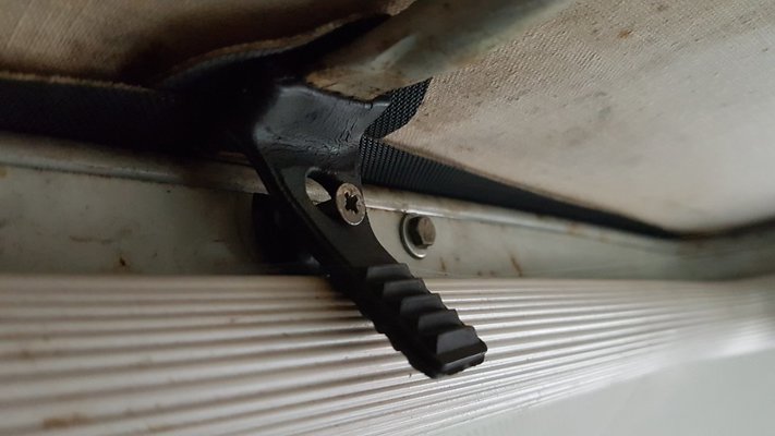

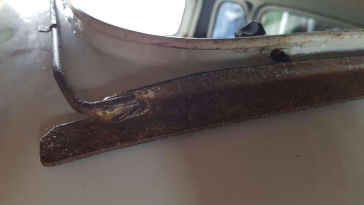

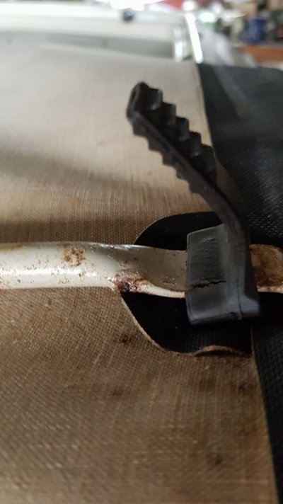

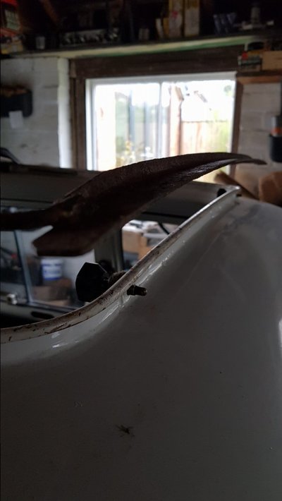

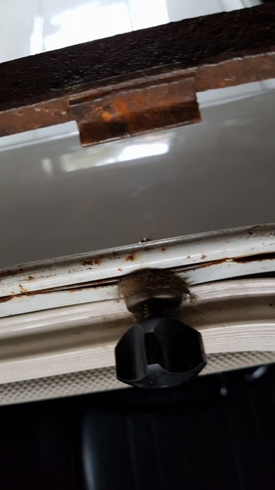

Hi Ron
These might help. Apologies for the light - it's not a great day for taking sunroof pictures outdoors!20200215_092605.jpg20200215_092554.jpg20200215_092333.jpg20200215_092321.jpg20200215_092619.jpg20200215_092712.jpg

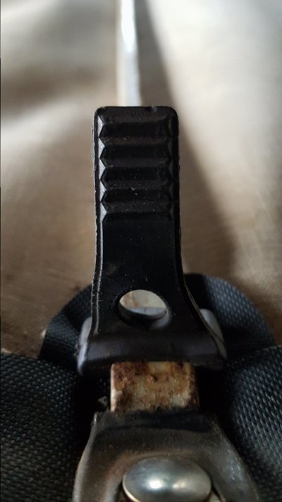

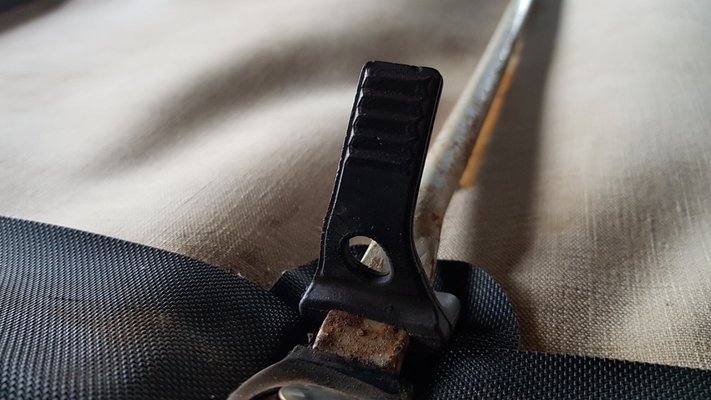

20200215_093024.jpg20200215_093040.jpg20200215_092424.jpg20200215_092348.jpg20200215_092512.jpg
Thanks for those Andy- they are great as I couldn't work out from the spares cat how this whole rubber thing was supposed to work.

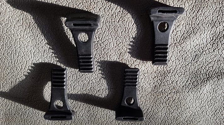

Hi all,
Sorry you have had to wait so long for this. I have the part prepared and ready to pour silicone. Just checking if everybody is still interested for me to go ahead. I appreciate it has been a while and you may have found alternatives. No commitment required from you until I actually produce the parts but just wanted to check there was still interest.
David
I received my share of rubber sunroof clips today, and all I have to say is that I am amazed by their quality - they look and feel like genuine parts. Congratulations to David!
I have some plastic pins (the part that these clips clip on - 79 03 081 012 / 77 03 004 138). I'm not sure if there are enough for one car, but I can machine them out of black Acetal plastic, if anyone is interested.
