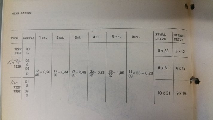

Just a quick question re speedo worm-drives in gearbox... Are they colourcoded in
respect of gearing? (for giving correct speedo reading?) -or How do I read them?
I can't see any codes/numbers on it at all. As always,Thanx Much for any info -R.
As nobody has replied I guess I feel it is my duty to try and provide some information I do actually have the genuine Renault workshop manual to hand covering all the gear boxes 354 and HA1 with every ratio listed I can only provide a copy of what the book says with no other ideas on whether your speedo will read correctly or not20151005_083714.jpg

I used the Renault 5 GTL gearbox with a 1973 Renault 4 speedometer and the speedo is accurate. I would give it a try. Both parts of the worm drive would need to be matched - there must be one part unreachable within the gearbox.
