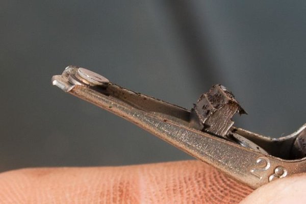

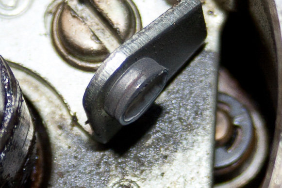

Good evening you fine, knowledgable people! Felicia my 1991 GTL has a tendency to stall when coming to a stop, and suffers from 'lumpy' idling otherwise.
The distributor cap contacts are covered in corroded gunk, although the points look clean. Tomorrow I'll find a feeler gauge and check the points gap.
I'll replace the distributor cap and points for sure, as well as setting the timing correctly. What else is worth replacing at the same time? Coil? Condenser? HT Leads? Spark plugs? Rotor arm?
And is there a good place to find them all in France?
For this particular problem of stalling when coming to a stop, where should I look first? From reading around, it seems to suggest a vacuum advance problem, does that seem right?
Sorry for so many questions, I'm learning a lot at the moment!

Those points are knackered! I'd go a good service and get everything set as it should be to see if it still misbehaves. Normally sorts these things.

They are toast. When I took it off, I could see the fixed point has a huge hole in it where there is supposed to be an electrode!
I'm replacing the condenser, points, distributor cap and arm to start with. I'm going to check the spark plugs and consider replacing them too.

Just thought I'd mention - I filed the points back down flat (temporary measure - new ones are arriving on wednesday) and reset the gap, and she runs like a charm now!
