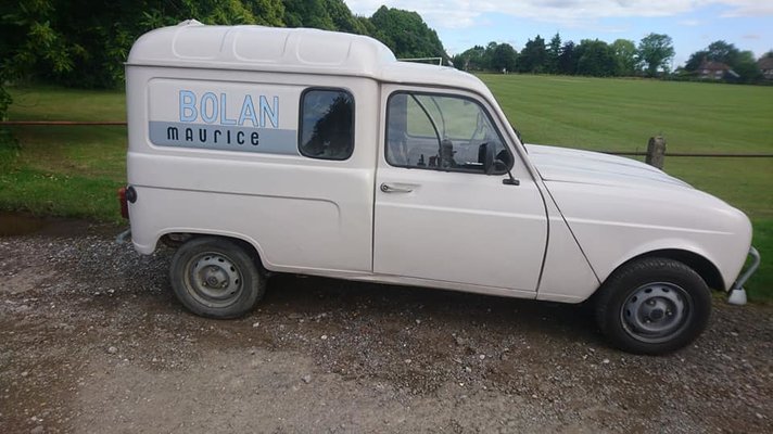

any recommendations for a quick post of Ducellier replacement - here or elsewhere .. oddly, I have just bought the electric ignition conversion that Jimthevan had listed.. on a side note, maybe for some relief, I've been pondering painting Maurice Yellow and Black - aye, Bumblebee ahoy4l2.jpg
