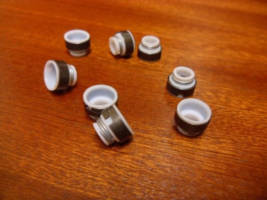

The machine shop was able to fit replacement seals for the one's they removed. They showed me what came out of the head, and since I have been looking at this stuff for about 48 hours straight. They look like those for an R5 GT Turbo. Like this:
Those look like the ones that keep turning up in my gasket sets. It will be interesting to know if I could have been fitting them rather than chucking them away.
One thought - It will presumably reduce the life of the guides if you stop oil running down them.
