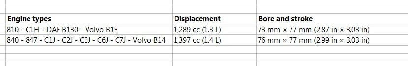

Renault supplied the 1108 cc Cléon-Fonte to DAF, who dubbed it the B110 and used it in their DAF 55 model.
Renault later also supplied the 1289 cc engine, which DAF named the B130 and offered as an alternative to the B110 in the DAF 66.
After Volvo took over DAF, they launched the Volvo 66, which was a rebadged DAF 66, with the same engine options.
When the Volvo 300 series was launched, the Cléon 1108 cc engine was dropped, while the Cléon 1289 cc version, called the B13 in the Volvo, carried over and a 1397 cc B14 Cléon-Fonte option was added.
Minor differences in the carburetor make, types and jets made the differences in engine performance in those days ;)
