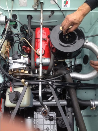

Neither of my cars has the long inlet pipe leading from the air cleaner. I often wonder if they're really necessary?
Good question - the hose is supposed to be there to allow you to change the air intake to accept warmer air in winter (from around the exhaust pipe) and cooler air in the summer (from near the inner wing). I always change over from winter to summer setting and vice versa; it seems to make a difference: www.renault4.co.uk/forum/threads/when-to-change-air-intake-hose-to-summer.1187
Very interesting to read a thread from 2007, thank you. when we were all 9 years younger!:)
My air filter has the adjustment screw in the centre, so I get half "heated air" from the exhaust and half "cooler air" from the inlet on the air filter cover. It's always been like that, but I must admit that the engine seems to run smoother in colder weather.
Perhaps its time to experiment and change it completely to summer setting. It was 35 degrees today!
The fikter is supposed to suck hot air from the exhaust when external temp is around 5 celsius degree. In my country it happens for a week per year. So I can even forget to change the position.

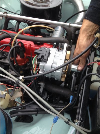

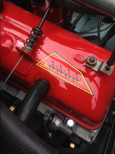

The big BIG day arrived on Saturday. Turn the key only to discover the starter motor just spun without engaging. Couldn't work it out initially sent an emergency message to Paul (Mr Reno) but he didn't see it . Having got the starter motor off again I could see that I'd miss wired the solenoid and connected to the threaded bolt not the little tab at the bottom. I've got all the fluids in and 5 L of petrol in the tank. I disconnected the fuel pipe to the carb and let it turn over a few times until I could see the petrol coming out of the pipe. Reconnected to the carb and away it went!!! Runs very smooth and not adjusted anything yet just followed Mojobabys setting on the dizzy. Suddenly WOMBLE IS ALIVE !!! And everything has changed. :clapping:Now it's not just an expensive lump of tin it's a little car that actually goes !! I'll get my son to help me and post some video on here. ( for I T I consult a teenager!) it's been a lazy Sunday ....too much celebration! :drunk:

Just love that little devils sticker ...Been saving that one until the engine was running....a great day!

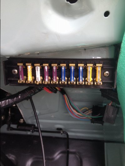

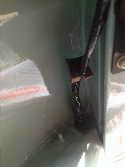

Onto wiring . I salvaged everything I could from that old body shell. The wiring loom was in poor shape especially at the back end. cutting up the wiring loom from the old body shell I was able to splice in exactly the right colour and thickness

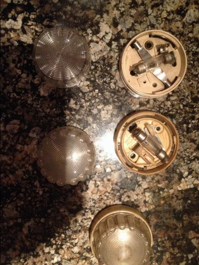

Delightful little interior light fitting . I just love the fact you have to turn it on manually and it doesn't operate when you open the door. Discovered the spares I have dont Match the original. The original is broken so I have to clean up one of the older ones and use that.

Jonathan, Excellent and well done! That must be such a relief to finally 'get to the end of the road' with the car. BTW isn't your inlet to the air filter in the Winter setting? The end of mine ends against the exhaust clamp although I wonder if that is correct. I would have thought that cool air would be better during our Summer months. My rocker box has a yellow sticker reminding the owner or mechanic that an oil filter with an M10 thread is required for my 1100cc engine. I wonder if those stickers are available?
Hi Azzazello! :hug: Yes I think there is a 5 devil version... but I like the 4 (one for each cylinder) Looking out for posts from you
Paul N Yes air intake is on the winter setting. Only because the tube ring support for the summer setting is in a state and I havn't restored that bit and put it on... Im being lazy! As I intend to use Womble all summer for 6 months as my main car maybe I should get on with that:(
