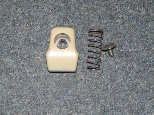

Is this what you need? If so, PM me your address and I will stick it in a padded envelope and post it to you. It screws onto a threaded pad stuck to the glass.

Didn't realise they screwed into the pad - assumed it was just a metal disc that stuck to the rubber pad on the glass. Are there two types?
I don't think so. I replaced my old metal framed windows with newer plastic framed ones and they fitted just the same. What is left on the glass in your car?
Then you have also lost the mounting that is bonded onto the glass. Not sure what you can do about that, apart from getting a secondhand window glass with the right mount fitted. I assume that you have plastic window frames, glasses from the metal frames aren't interchangeable, I don't think, so the glasses that I have are probably no good to you..

This is a reminder to put a dab of Loctite on your window catches, just had one of mine spring to pieces in my hand, and on checking the others all three had come almost fully unscrewed.
