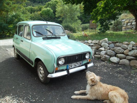

How do you get the catches to stay on the windows? Glue keeps failing, very frustrating! Any suggestions greatly received. MintySAM_0017.JPG
