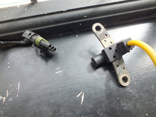

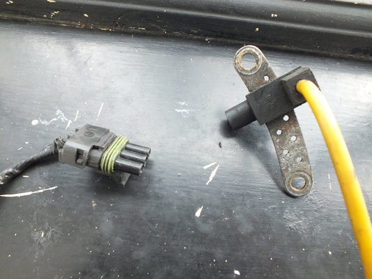

Thanks Paul, you are a genius! After carefully drilling out the holes (in a pillar drill with a limiter to stop drilling right through the sensor), the plastic body could be tapped along the mounting with a hammer. It is a tight fit so probably won't need glue. Before and after photos attached.
What a transformation! The engine has much more power, is more responsive, smoother, less boomy, and it is fun now! I've been driving around much too quickly this afternoon. It might well take one or two more degrees of advance as there are no ill effects and there is still a very slight boom. The Renix is the 031 - the curve seems to be a good match for the engine.

4 degrees is as far as it would go without the sensor hitting the edge of the hole in the bell housing. Boo hiss -I wanted to try another couple of degrees. I might file the hole out a bit when I fit the higher ratio gearbox.
