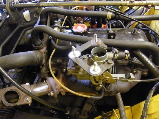

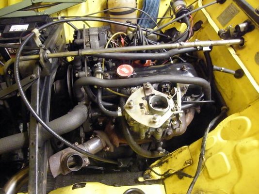

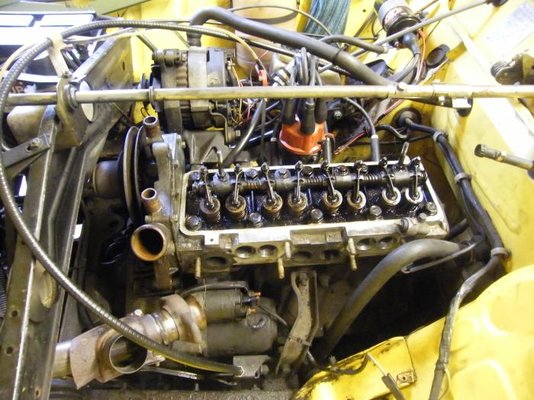

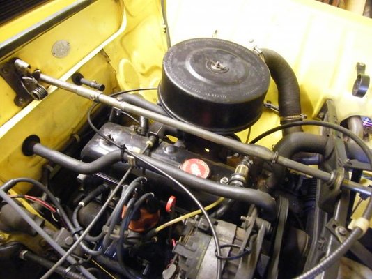

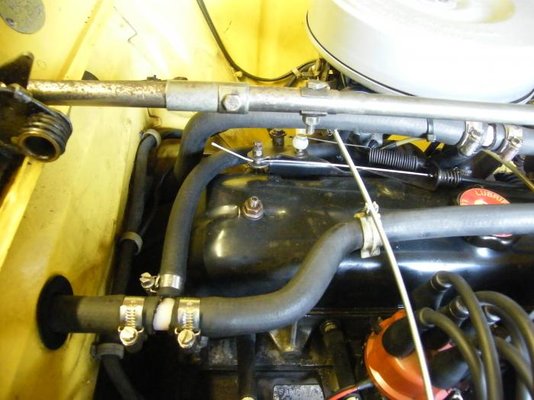

Apologies for resurrecting this old thread, but I have just converted my R4 to run a 32IF7 carb and so far all seems well. I did buy a seconded-hand R5 water pump with the water take-off to the carb but on attempting to remove the original pump I feared I was likely to shear off one of the bolts, they are only 6mm dia, and besides my pump is perfectly ok, so I left it well alone. Derek Flavell from Renospeed had suggested I tee into the heater pipes when I was chatting to him at a show back in the summer, so that is what I did. It works fine of course. I had rebuilt the carb with a service kit picked up in France and some parts I bought off Steve so it's in good nick now, now it's just down to fine tuning. By the way, the plastic tee-pieces came from a UK based firm called Advanced Fluid Solutions, they are based in Essex. The size I used was 18mmx10mmx18mm. Marigold is now ready for some more continental touring next year, bring it on!:D
Here are a few before, during and after photos.

Looks good Brian - see you didn't hang about. I also like the T piece conversions too. The hot air take-off from the exhaust manifold is so vital with these carbs.
You'll be at Santa Pod next week;)
Hello Steve, yes I'm pleased with the way it's turned out, and it has made a noticeable difference to the cars' performance, and although I don't think I will win any "traffic-light grand-prix", the acceleration is very much improved. Top end? hmm I think that is better too. I noticed the main jet had 110 stamped on it, presumably 1.1mm, would it be an idea to fit a slightly bigger one do you think.
I used to wear out a set of front tyres every month doing the traffic light grand prix ;)
You may have trouble sourcing larger jets but worth trying some specialists. I cheated and bought a set of micro drills and opened up the jet by one increment until I got where I wanted to go. See how you get on with the performance first though :)
Hmm, funny you should mention tyres, I need some new rubber on the front anyway, then maybe I can take on the local oiks in their Saxos and Corsas. I've had a look on line for bigger jets, but no luck, so micro drill-bits it is if I feel the need for more power.:D
For now I will just get used to it as it is Steve as you suggest, but it certainly is a different car now.
Thank you for the info Steve. Yes I will leave the main-jet for now and just tweak as required, but I've just ordered a new toy, a gas-analyser, a bit of gear I've promised myself for some time, so that should help the tuning process.
Hi Steve, it's a DIY one from Gunson, yes I know it's a bit OTT but it will come in useful for other stuff we have in the fleet as well, and friends classics too.:)
