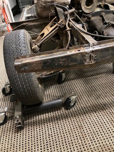

Yes, Joop. I have seen many blogs and Youtubes of R4 chassis with severe rust, and as I bought my car sight unseen from another state, I was expecting to have to do more work on my own chassis. Naturally I'm very happy with what I have got.. My work will be in the body, where every panel has been heavily filled with putty, and where surface rust has generated between the putty fill and the panel, needing descaling and then a lot of heat shrinking and hammer and dolly work.. As a few hours on that I think.

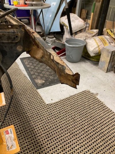

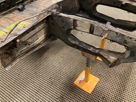

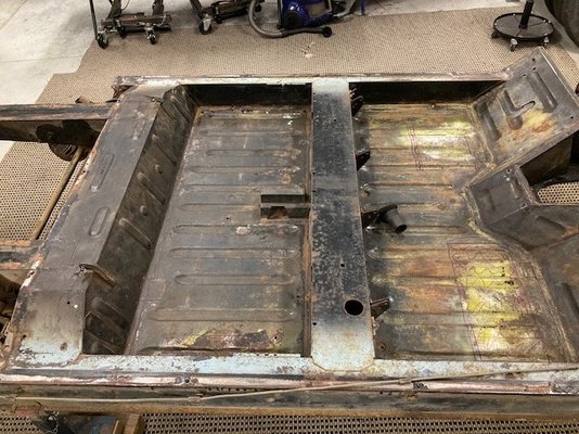

I have almost completed installing new drivers and passenger-side floors into my chassis to remove the rusted bits. Photos to follow soon. I tried welding patches to replace only the rusted area, but the floor panel was just too thin for my welding ability, so I replaced the whole section from rail to rail.

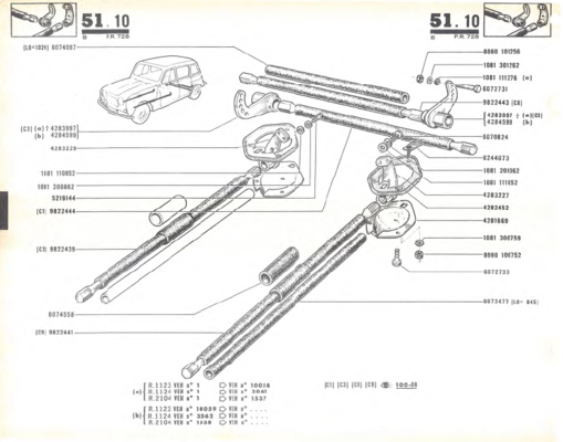

While am waiting to set up to paint the chassis, I have started on the front suspension. First question is-all four torsion bars have a plastic sleeve over them. It is fairly knocked about and untidy. The bar inside them is nice factory finish flat black, so no corrosion has ever touched them. Is the plastic covering important? And if so, can one purchase it reasonably? Is there any aftermarket normal hardware plastic tubing available to substitute? Thanks. Ian.

JdeW, you can see the plastic sleeves Ian is talking about on the picture, its part number 6074087 and 6072477. They were fitted on all R4s up to around 1983 model year.
Their purpose is more important than it may seem at first. Stress at a torsion bar when it is twisted is increased linearly from its centre towards its outside, where it gets highest. Under some circumstances it's possible that a stressed torsion bar will break when something hits it at its outside with relatively little force. So these sleeves are more than a protection against dirt or corrosion.
The best substitute I have found is heat shrinkable tube, the thick type with glue inside. It will shrink around three times its initial diameter, so if you get some with 35-40mm diameter you will be OK. Best way to shrink them after fitting is with a hot air gun, but you can also use a propane torch provided you move it reasonably quickly.

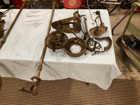

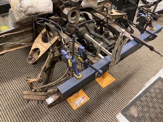

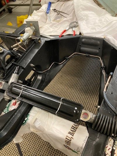

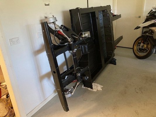

So, as I enjoy looking at others work to get some inspiration/ courage, here are some pics of my progress. Front suspension parts have arrived, so once the chassis is painted, I can start to clean/paint/assemble that. With the exception of the right side torsion bar at the lower control arm , everything came apart smoothly so I didn't need to apply my usual brute force and ignorance.

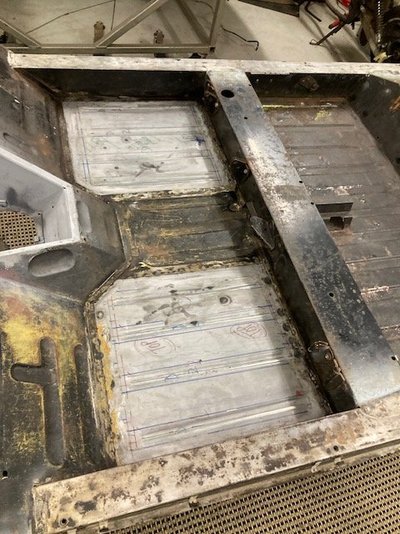

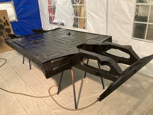

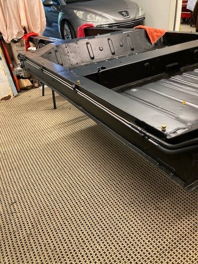

I made up floor panels, and then plug welded them in from the underneath, as that then looks the closest to standard with the seams inside. Tomorrow I will get onto getting rid of the rusty scale throughout the inside floors, and apply etch primer. Then seam sealer, then paint.

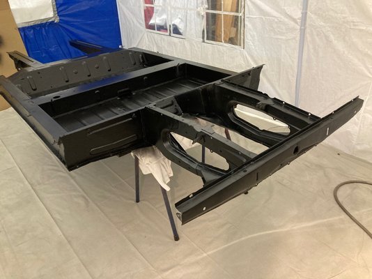

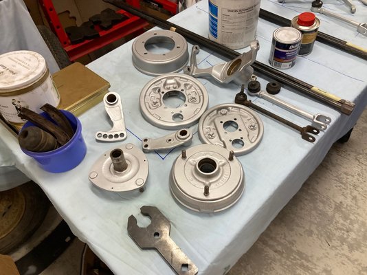

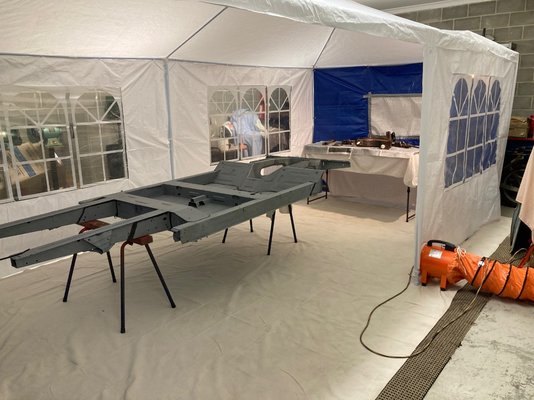

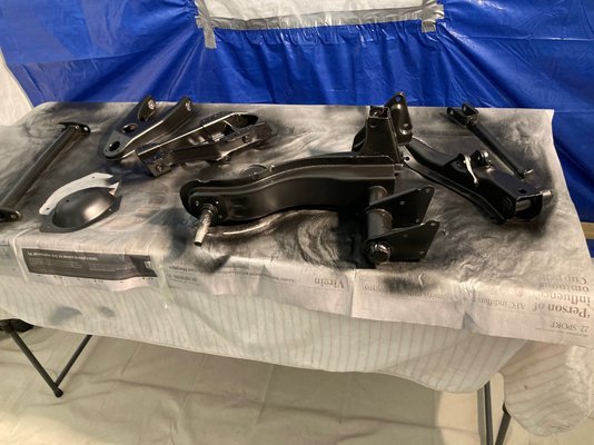

I'm finally able to get back into the garage and take my project forward. I assembled a "spray booth" in the garage, using a cheap 3 m x 6 m garden marquee, a reasonable quality exhaust fan with a 12 m exhaust flue and a good quality painters Mat to soak up anything that fell. Worked a treat, I didn't have any overspray around the garage once I'd finished. I have now primed and painted the chassis both sides, and repainted all of the brake and suspension components ready to assemble. I obtained the various ball joints ,bushes, bearings, bolts ,et cetera from various suppliers and hope to have a rolling chassis by the end of Easter. Then I can get serious about the engine, gearbox and then finally the actual bodywork. I appreciate the help I'm getting on the way. Thanks. Ian.

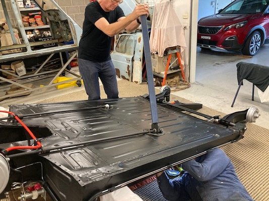

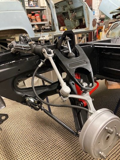

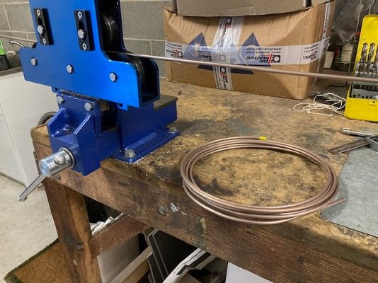

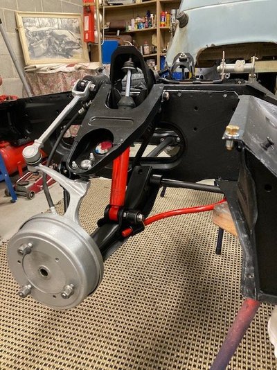

"By the end of Easter" actually became well after Easter. As usual, other things got in the road. But I now have a "rolling" chassis (although it's now standing against the wall to give me some more space in the workshop). I got all of the suspension components mounted with the new parts, and as you'll see from the photo, found an easy way to pre-tension the front torsion bars. I set them to the position they were in when I got the car, which is pretty central in the settings, so can adjust the corners a little bit if necessary. The wishbones et cetera are still fitted loosely, as I can't finally tighten them until the car is sitting on its own weight so that I don't strain the silent block bushes. I was at my car club chatting about the project, and mentioned that I was about to make the brake and fuel lines, and one of the members offered to lend me a machine to straighten out the coiled brake and fuel line material. How amazing that is. To be able to work with perfectly straight tubing allowed much easier and more accurate bending. There are a couple of pictures of the finished brake lines. I'll call that stage I finished, and now I'll dismantle the engine and transmission to see what I need to order to get them running. Ian
