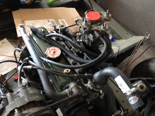

you can check for air leaks by spraying WD40 on all the connections if it starts to run better you might have found the source IMG_0461.JPG
The pipes with the y connection are the breather pipes, usually the connections are cracked because of age.
the topmost pipe connected to the y connection runs to the inlet manifold just underneath the carburetor. There should be a restriction in it.
If its not there you're engine won't idle if all the connections are ok.
The restrictor is a small piece of plastic with a 1,3mm hole in it. It fits neatly in the breather pipe.
If the restrictor is missing and all the connections are ok.
As a quick fix you can either make a restrictor yourself.
take a bolt that fits snugly in the breather pipe and saw the head of. You want to end up with a piece of about 10mm. Drill a hole of 1,3 or 1,5 mm through the length of it and push it in to the breather pipe and re connect it.
Or block the pipe that runs to the inlet manifold.
good luck

According to Wikipedia only a few Spanish R4s between 1972 and 1976 were fitted with the 852cc Type 813 engine. It doesn't feature in my 1971-1975 parts book but it looks as if it was only to applied to R4F4 vans. Possibly your car, if it's not a van, has had an engine swop at some time? From the photo the engine looks a bit more sophisticated than the standard 845cc "Ventoux" engine which one normally encounters.
Thank you for that;). That is my own 845cc Ventoux.
It is somewhat over-engineered, but it does a good job in my R4TL sinpar

Try to keep it running with the choke on. if it runs better you probably have an air leak.
My experience is that probably one of the breather pipes from the rocker cover to the carb. and to the inlet manifold is leaking.
Or there might be air coming in from the connection of the carburetor to the inlet manifold.
you can check for air leaks by spraying WD40 on all the connections if it starts to run better you might have found the source View attachment 17147
good luck

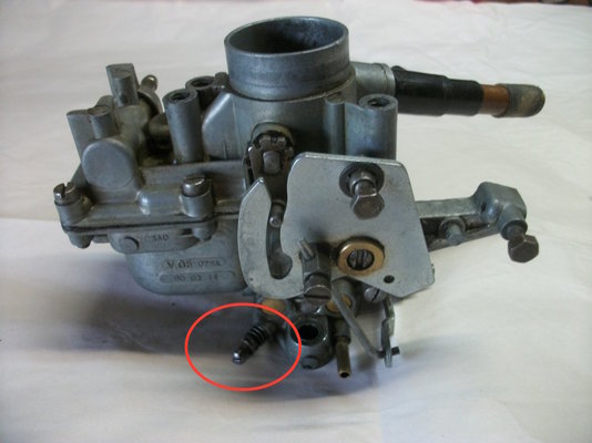

Hi there . I also have a 1972 R4s which apparently is Spanish built with a Sierra motor with 5 bearings . My question is which is the mixture screw on the carb because although the motor starts and runs it does seem to run a little rich .
mojobaby
1,228
#19
You might not have the same carb as me, but if you look at the below photo, it's the screw on the bottom left, the one with a spring around it.
Before you start trying to adjust it, screw it all the way, counting your turns. This way you can always return the screw to it;s present position.
My carb is set on 2 1/2 turns outwards
