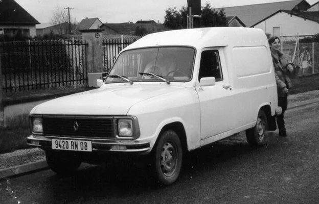

Van plans are shelved for the time being, if I do come back to them it'll be like the Ami is done as it looks teh part and is easy to revert to original. I have a little update today.
