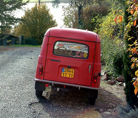

Not a problem we have as we have nowhere flat to park Claude outside our house(s) - checking the oil level, now that's a different problem, and is mostly done in supermarket car parks :roll:
PS The lake in the background of the photo is normally a green field but the picture was taken during last November's floods.
mine looks just like that on the flat :)
