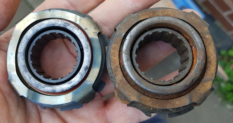

The release bearing in the 334 TL kit is on the left in the photo; the one on the right is a used bearing from a GTL (180) kit - they seem identical. So that's my concern - will it be okay for the 1972 TL 160mm kit?20250411_104731.jpg
I understand what your concern is.
But when all measurements and dimensions of the clutch release bearings (either for 160mm or 180mm) are the same then it should be alright.
The model years 1971 to 1975 with either 334 or HA0 gearbox all have a 160mm clutch group and the same clutch release bearing as the later 180mm clutch group.
Maybe @angel can provide a second opinion.
There was no 180mm clutch for the Billancourt engine, and most 1108cc engines were fitted with a 160mm clutch, too.
All ball bearing release bearings (1969 till end of production) are interchangeable, no matter what the gearbox type and clutch size.
Reason Renault gave two part numbers (besides their habit of randomly changing part numbers!) was that one number was a sealed type used on poor road / special equipment cars. I think that all aftermarket release bearings available nowadays are sealed anyway.

Thanks a million, Angel - your second sentence was exactly what I wanted to hear!

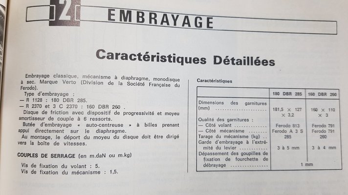

Yes, I know that all Billancourt clutches are 160mm, and that, according to the RTA, early F6 clutches up to #153412 are too. But the RTA also says that R1128 clutches are 180mm - both the GTLs I've had, as well as my F6 (1983) have had 180mm clutches.

Here's the RTA page (it was written in the early days of R2370s/R1128s):
