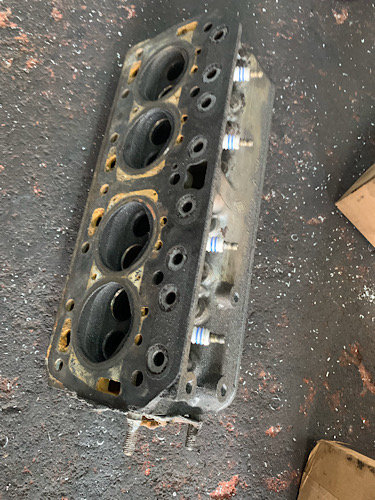

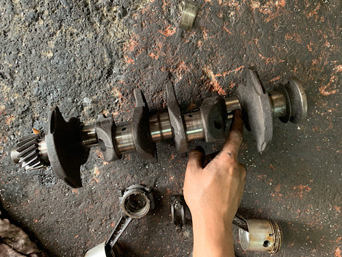

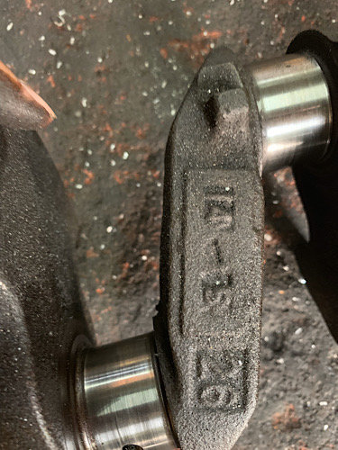

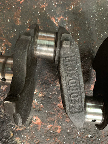

Tobiaspeng Enthusiast Messages 21 Location Malaysia Singapore Oct 9, 2019 #1 Hey there , this is for R1124 project I need buy a whole crankshaft if possible , it’s worn off . For 845cc R4s 1964 If not will need the whole engine , and suitable upgrade gearbox as well ... thanks F1877038-A035-4D93-A995-332560F439CB.jpeg 85.3 KB · Views: 1 DFC32437-F912-4A5A-871E-A0D14D3F2322.jpeg 105.3 KB · Views: 1

Andy McGhee Enthusiast Messages 1,809 Location Cheltenham Oct 9, 2019 #2 It's worth having a look at this: https://www.ebay.fr/itm/Renault-R4-R5-R6-vilebrequin-moteur-800-Billancourt-7700506353-/163790913286 The seller says it fits all 839/800 engines (the number on the engine plate), but please check it's the right one for your car!

orsome 1 Messages 290 Location FIN Oct 10, 2019 #4 you mean it is not anymore possible to be grinded for undersize bearings?
P Piet Enthusiast Messages 233 Oct 17, 2019 #5 Tobias You shouled be able to get the crank reground for undersize bearing shells, as there are stock undersize ones you can buy for it. If you are seriously looking for another crank try this on Ebay in the USA: https://www.ebay.co.uk/itm/Wheel-Ho...219655?hash=item5934b2c207:g:s~wAAOSw-9tdb6Cb or https://www.ebay.co.uk/itm/Wheel-Ho...750285?hash=item2ee1f9f48d:g:-b8AAOSwuxFY3rPf Cheers Piet
