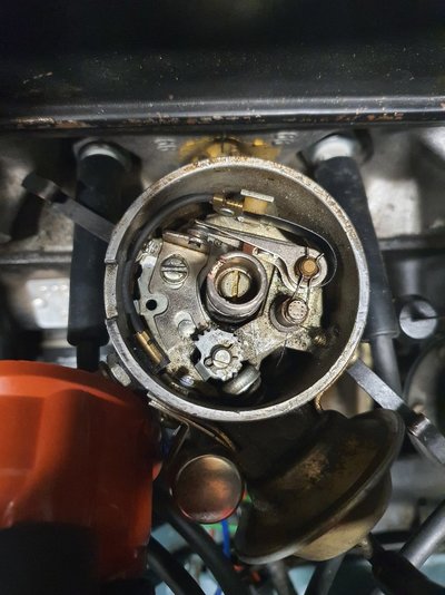

So I rebuilt the carb, fully cleaned all the jets, new fuel pipe and filter and it still runs rough, checked all the plugs and they look OK, I gave them a clean and it still runs badly, checked the points and they don't look the best, I undid the disi and moved it slowly to see if this helped it run a little better and there was a slight improvement, so next steps swap the points and re do the timing, does anyone know the best place to get a set of points in the UK, I have a duciller disi.

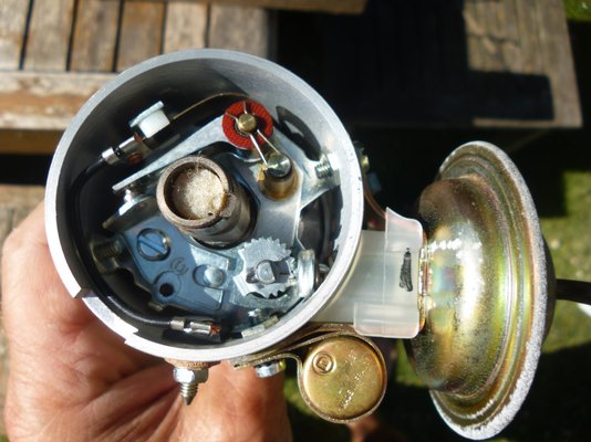

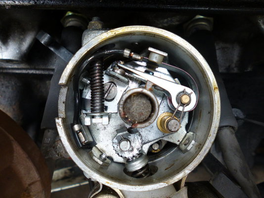

Is your Ducellier the usual type (1st picture), or is it the type with externally adjustable points (2nd)?
Have you checked the condenser? It's sometimes referred to as the capacitor, but it's the same thing. If the points aren't in the best of health it's often sign that they've been handling too much current, which is precisely what the condenser is meant to assist them in handling. There's a way to test if the capacitor is failing, using a decent multi-meter and I should investigate this as well. For some unaccountable reason the condenser is often overlooked. Happy to advise further if needed!
Yes, I had a fairly new condenser fail, and it resulted in the car barely making it up hills.
When you say "checked the points and they don't look the best " did you some measure?
The points have probably become pitted as a result of the capacitor's failure, allowing too much of a "jolt" going through them. This "jolt" is cushioned when the capacitor does its job properly and I suspect yours isn't.
I am happy to report I have a well running Renault 4, popped over to see Brian Whiteside this morning and collected new old stock, disi cap, rotor arm, points and condenser, timed her up by jacking up the front wheel and setting the timing to 7degs before TDC, set the points and measured the dwell at 56degs, started on the button and drives and pulls a lot better, so having thought it was the carb at least that's had a clean, new float valve and diaphragm, new fuel filter and replaced the crumbling fuel pipes. I also replaced the vacuum advance pipe as it was toasted. So I think my issue was points and or condenser, suspect the points that I got from my local motor store where cheap ones. They are lucas parts now.
