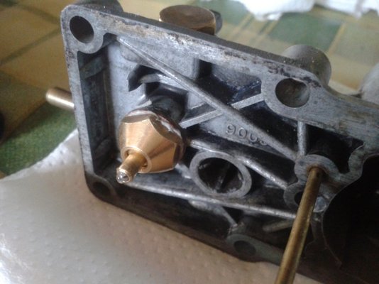

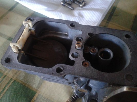

I will try to solve the problem Teflon and sealing compound, if possible (also at number 10)
I'll upload some photos of the process so you can see.
Thanks for your help.
I still have the broken carburetor.
I used teflon and sealing compound and has not worked
