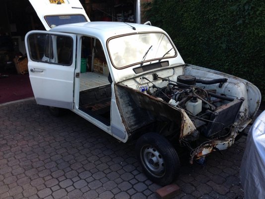

The bonnet more or less fell off.

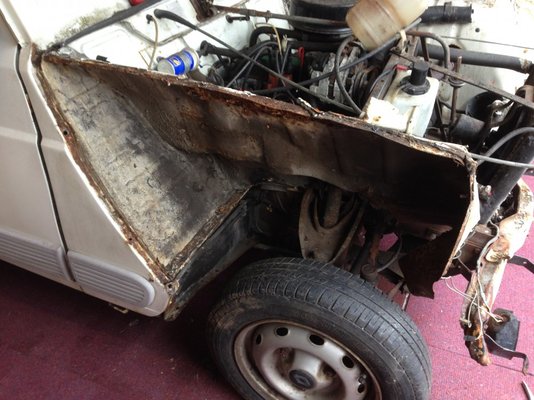

Getting the right hand side wing off was fairly easy.
Initially I thought I'd leave the left wing as it is solid and the inner wing has been patched, but now I've decided to remove that side as well.
However, I am currently stuck as I cannot undo the bottom nut and bolt that holds it to the triangular panel behind the wing and I cannot get my angle grinder to it.

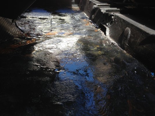

When I removed the rubber floor mats, it was not a pretty sight.

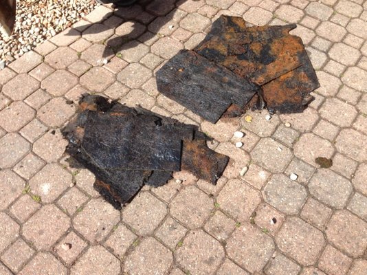

I guess this was once soundproofing.
I then removed the front doors to give me easier access to the interior. I almost removed the rear doors but thought they might provide structural strength when I remove the body from the chassis (?). So I left them in.

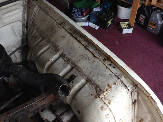

To remove the right inner wing I needed to deal with the brake lines which passed through a hole in it.
However, I was unable to undo them at the master cylinder so ended up cutting them. Note there are only three lines.
As you can see I was able to undo one of the lines.
The inner wing then came off easily.
