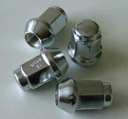

problem solved.i bought a set of blind nuts for quad alloys( m10*1,25) and addapted em to 45 degrees ?pitch?. perfect!

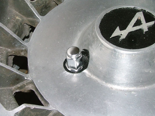

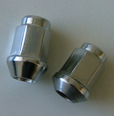

Here is my solution - I bought the nuts for Taiwanese fourwheel bike (picture 1), there is M10 x 1,25 and the taper 60°. They are quite cheap (1.88 EUR each). I turned the taper out for 45° (picture 2) and it looks quite good (picture 3),what do you mean?
