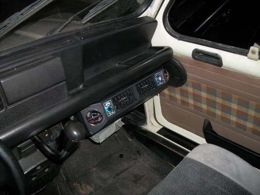

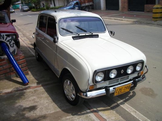

So I had Air installed in my R4 GTL.
It was a big job but well worth it.

Can you send us picture of the compressor and other engine bay components as well? A friend of mine has an A/C (among other mods) equipped R4, and the previous owner who did the fitting had no other place to put the compressor than directly over the gearbox. That meant he had to use the Renault 5 shift lever on the floor. Did you manage to fit the compressor and clear the gear lever?
Mine is a left hand driver seat. So I'm not sure if that makes any dif. But he reversed the comp and all was fine. Will post pics soon.:hug:
