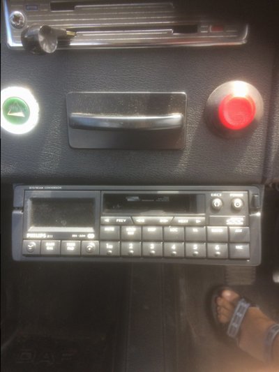

IMG_2284.JPG Here's my Philips DCC811 digital cassette player and radio, fitted to my Daf 33. The sound, through 2 Radiomobile speakers mounted under the dashboard, is truly amazing! The radio, as well as the usual long, medium and VHF/FM bands, has a short-wave band, too. I've yet to pick up Radio Moscow....
It plays ordinary cassettes to a much higher standard than a normal car cassette would and I've ordered The Jam's Greatest Hits on a DCC cassette, to compare!

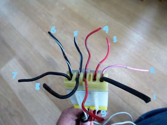

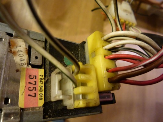

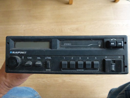

I found this Blaupunkt radio/cassette player in the garage today, but have no idea how to wire it up. Can anyone identify the connections?
Do you know exactly which model of Blaupunkt stereo it is? That might help.
Unfortunately not. All the other Blaupunkts I've had were named after a city and had their names prominently displayed on the front. They were also very easy to wire up, with a live feed, an earth and speaker connections. I'm just hoping that someone will remember having one of these and where all the wires go!
It would be better to take pic of cables coming out of the Blaupunkt itself, as the wires you show would be specific
to the car it sat in -If you know WHICH car the wires you show comes from you could easily find out which wire is
what by speaking to car-dealer or go online...
You will have two pos (one always live(for station-memory) the other one is live after ignition.(On/Off)
then you've got one Earth/Ground either three (if shared Minus) or Four -to speakers (if separate Minus)
then you'll have one Plus after you turn on player (for el.antenna/amp etc)
Usually current/power and signal/speaker-wires are Separated on each end of connector-block to minimice hum/noise
-Reid.
