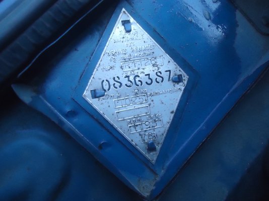

This is absolutely critical (you probably already know this, but there are 2 types of R4 engine - 'Billancourt' (845cc and down), and 'Cléon' (852cc and up). They're completely different, and you can easily end up with the wrong parts if you're not sure what you're ordering)! If you could tell us what the numbers on your oval plate and engine plate are, it'd be a big help.

The plate under the bonnet says it is a billancourt R1126, and the numbers in the middle say 4 and 100.
I will take a photo and put it on to show you.

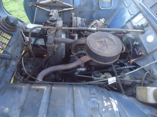

Here is a photo of the engine I am just learning where everything is. We're not sure if we have solved the problem with the starter motor and might need a new battery. Now we are having trouble taking the brakes apart to check them. We are cleaning her up and she is lovely some rust but hopefully not too bad Thank you

looks good!
before you run the motor too much lift the speedo cable off the exhaust pipe - that won’t help the speedo to work.
it also looks like you have drum brakes all round - first there’s no servo and second I can see the handbrake lever under the exhaust pipe.
Make sure the handbrake is off and that the brake adjusters are all undone before trying to get the drums off, they can still be a pig to remove and may need tapping off from the back with something soft. Don’t use a hammer you may split or crack the drum.
Be careful with the brake dust, it may contain asbestos - depends on when the shoes were changed last - best to spray with water first so you don’t breath it anyway.
