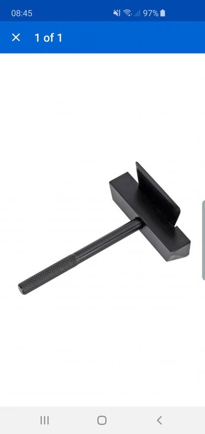

You can use small flexible knife and hammer it in . Or there is special tool
