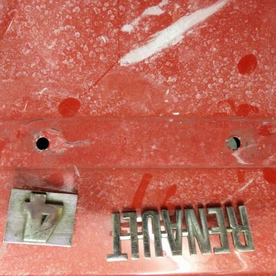

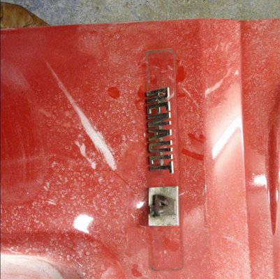

Hello everyone....As I'm now officially a Renault 4 Anorak Fanatic...I need help with accurate positioning of the name badge/emblem. As some of you will already know I'm making my GTL look like a TL ....So I've taken the plastic badge off and now have two large holes I will have to weld up. But needing some help with positioning...so if one of you has a good photo and a measure that would be much appreciated especially as it probably freezing cold out in the garage right now :rolleyes:

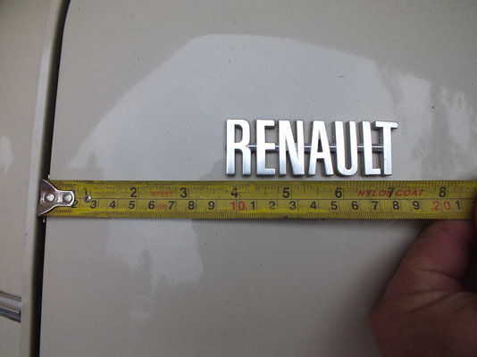

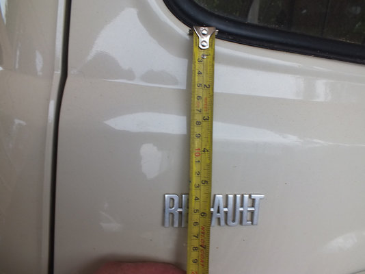

I forgot! Here are some pictures.
That's a great help ...thanks Malcolm.
Old holes welded closed ...new ones shortly to be drilled.
