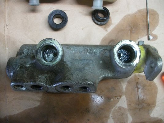

Here are 2 photos of the master cylinder that was in the car. I thought that it was faulty and thats why I bought a new one, which I now think was probably not necessary.
In the first photo the 2nd from the left appears to be a spare outlet, but both 1 and 2 lead to the back brake regulator valve.

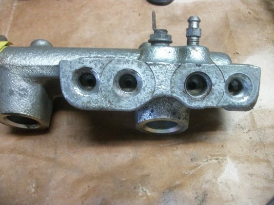

Same master cylinder, just cleaned up a bit. Can you tell me what the nipple is used for. Is that perhaps for bleeding the master cylinder?
It looks a lot like a bleed nipple for the master cylinder, but isn't that at the bottom when it's in the engine bay? If so, it must be only a drain. Any blanks screwed in need to be air-tight, else working the piston will suck air into areas just bled (yes I did do that!).

Yes the nipple is towards the bottom, probably in the 4 o'clock position.

This bleed nipple is to bleed the pressure drop indicator circuit (a separate small piston). Without doing this you will never get rid of all the air. You have to first bleed the four wheels just like you did, then bleed this circuit, then possibly go over the system once again, but always ending with this nipple.
There is no point "bench bleeding" the master cylinder, as air will enter the lines again when putting the master cylinder back on the car. Plus, with a full master cylinder and fluid leaking all over the place, it will be a hassle to connect back all four brake lines.
