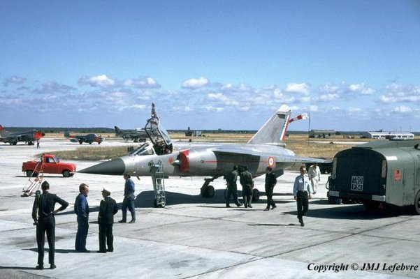

The red car is a 1972-ish Renault 4 Pick-up. Later the F6 became the platform for the Pick-up version.
