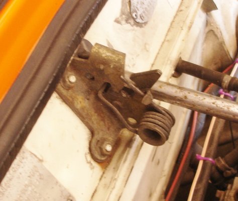

Hi Tom, this is my bonnet catch, as you can see the spring is held in place by a hole, is your catch like this? I assumed it's a repro one as I've seen them before where a hook is used to retain the spring. I've checked the Melun Retro and de Franzose catalogues, and Melun appear to do one, but I'm not sure if its the same, and De Franzose only seem to do one for the very early cars. Maybe someone on here can add something to your query. Sorry I cant be more helpful,
Regards Brian. View attachment 23951

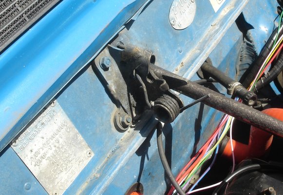

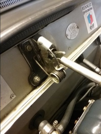

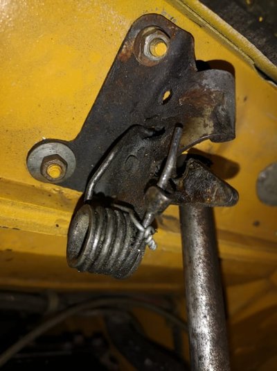

Taken some pictures of both my F4's bonnet catch.
First as it is now before sorting out and the second batch on my other F4 which has not had a problem
I have now clipped the spring where it should be and will 'lock' it into position.
Tom, i would be interested to see how you lock it into position, will you just fold the tab around the spring or do you have a more ingenious method in mind

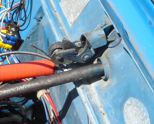

Pictures mr-reno sent me as a guide.
As ever when you want something, no locking wire to hand.
As a temporary fix have used a thick cable tie and this appears to be working well.

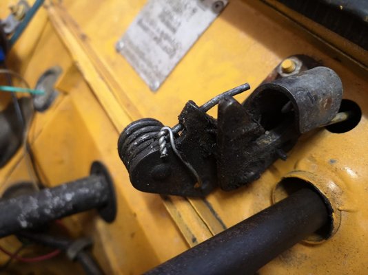

I have posted my fix before-I drilled a hole through the catch-Treaded a wire through hole and used a wire-lock to keep it there
wire runs down via innermost part of firewall,there's a drilled hole at the bottom edge where wire goes through-made a loop
threaded up through hole again,secured with another wirelock .Now if spring breaks or jumps off or rust takes it's toll on the
bonnet-catch all I have to do is stick a pole or someth' from either side into the loop underneath and Hey-Ho bonnet makes
that familiar quality-sound telling it is
Open.................-R.

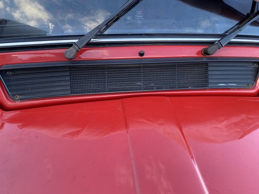

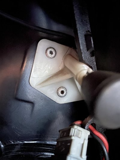

My bonnet is also stuck shut. Tried pushing/pulling as suggested on other posts.
The push rod inside the car is "dead" - whereas it used to be really stiff to push the bonnet open, it's now loose, so probably broken or out of place. All it does now is open/close the heater ventilation grille on the first photo.
I read somewhere about taking the rod out and trying to use a screwdriver through the hole, but it seems to me like the (plastic) shaft for the rod is riveted in - any suggestions?
Is it possible to access the catch mechanism by removing this ventilation grille?
Any other ideas?
Thanks in advance...
