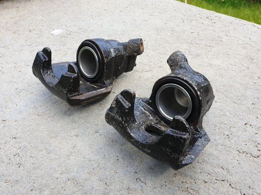

I've broken a brake bleed nipple flush with the caliper on the F4 van. It didn't take any force so I guess it was quite rusty and will be tricky to remove. I've got Bendix calipers.
Normally this is a sign that the caliper is 35 years old and will cause other troubles, but the only new calipers I've found are the 150 euro each odd looking ones from Der Franzose. Does anyone know of cheaper ones? Or the holders for the odd pistons as I have a couple of them.
Failing that what's the best bet to remove the broken nipple? I don't want to risk an extractor so guess drilling out is the answer. Or something involving a lot of heat as it looks like seal kits are still available. Guessing it's M6.
All the mainstream places seem to be 'out of stock'. Paul (mr-reno-139 on here) suggested Big Red https://www.biggred.co.uk/ for parts or reconditioning. Looks like we're back to the old days of rebuilding calipers.
Only one piston on each caliper so I've paid £15 for new seals. I'll need seals as I'll use heat to remove the bleed nipple on the other side. Also good to have front brakes that have a chance of not binding for another 20 years.
I keep left hand drills for exactly this occasion, and this is easier since you have a pilot hole in the nipple.
It's too late in this case but good advice given by an independent specialist of a particular marque is to undo each nipple at least each year to prevent them seizing. With just half a turn there's no danger of air entering the system.
