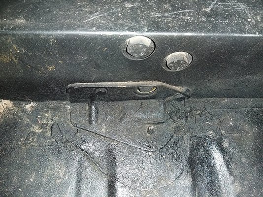

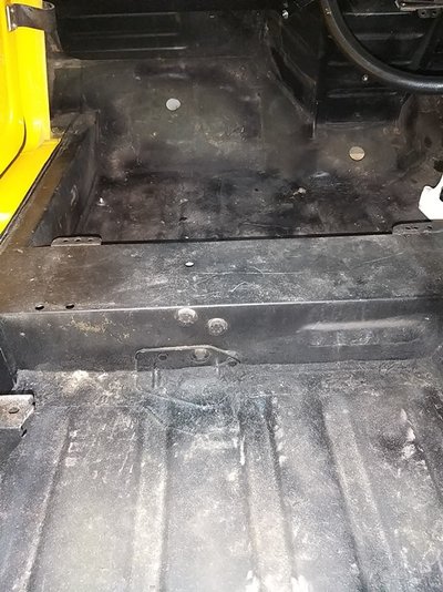

Thanks Angelos ! Strange that it is registered it as a 1978 R4 TL 845cc, although it is a post 1983 1108cc car with matching engine/body numbers ? Maybe they made a mistake when it was first registered here ?This is a late chassis! Holes on the front floor toeboard and handbrake lever bracket confirm this, too. I think it matches the body - the whole car in fact.

I had already suspected this when I replied to his original idea of changing the dashboard and I said it will a later car and it is virtually impossible to fit the early dashboard to without serious work including switches steering column and wiring I did mention by private messaging the same suspicions that I had but thought it wise not to mention in publicWait, I asked you for a photo because I suspect that chassis number only may had been transferred on a later chassis. Front torsion bar anchor points will tell us the truth.
Also I see you have internal door hinges and small tailgate hinges, so whole bodyshell is post-83.
