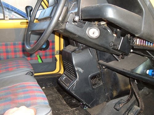

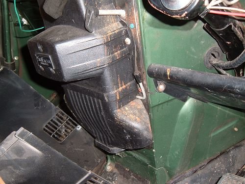

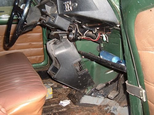

I need to know the same thing so thought I'd investigate. The console fits a GTL OK, but it was designed for that. On a TL (mine is a 1973 L) the outlet for the heater sticks out too far, and the console would need to be trimmed to fit. I think it could be done neatly. Also the lever for the vent flap might need to be altered, or the console trimmed to fit. In the photo I haven't fitted the console to the car very accurately.
The green car is the '73 and the yellow one is '83.

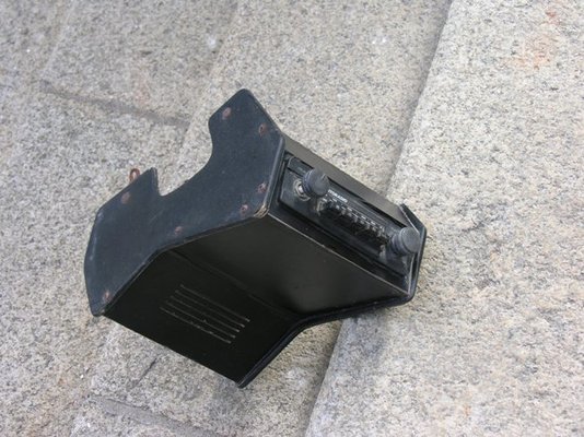

I now have a radio console for the seventies R4s, found on an early GTL. I'll attach a picture soon. It fits below where the heater outlet juts out unlike the more modern stereo console, and the speaker goes below it rather than above it

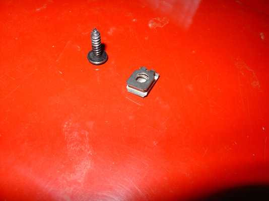

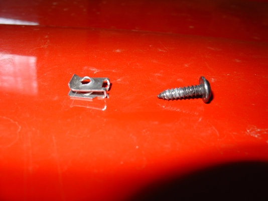

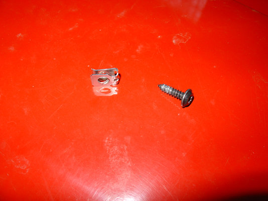

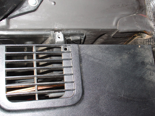

In the Malcoms post there a picture of a yellow radio panel. My got unscrewed, before I even buy or install a radio I want to screw it back that it don't jumps and rattles around.
I found out that it was attached with a screw on both sides, just underneath the air holes. So I've got only one screw(yes I'm gonna buy the second one), but did this screw had a nut or it was just screwed in the plastic?
I went today to my local R. dealer. And after half an our of talk they gave me two U form metal pieces with a hole through.
I put them on the inner plastic an then normally screw it and it hold.
Nice now can I buy me a radio:o

Hi, as I promised, here are the pictures.
Hope it helps.

Thanks...
It looks some way different from what I would use to replace it but they will (I hope) work quite similar... I will have a try to look from a local renault dealer (I have to ask for a new fuel tank), but I have not much hope for both... Just to say: "I try...".
I think they could be as well substitued with a rectangular piece of metal, previously threaded... Probably more easy to find...
