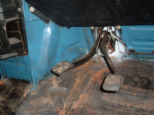

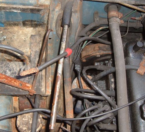

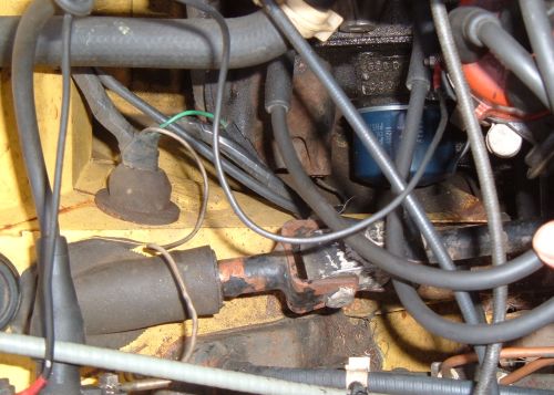

Here are some photos of the GTL vs L bulkheads. I stuck a 1100 engine in my TL a few years ago. The bulkhead can be modified by a lot of hammering, although I'd probably be inclined to cut and weld these days. The other issue was the fuel pump which fouled the handbrake mechanism. I moved the handbrake mechanism to the other side of the car, but an electric fuel pump would probably be more sensible.
I'll post photos of the rest of the car in a new thread.
The side of the '68 bulkhead looks a lot like a flat panel
The GTL bulkhead has a deep depression to clear the back of the engine and the oil filter.
Thanks very much for the photos. Do you think you could get away with the original bulkhead if you fitted a remote oil filter? Or would it be just too tight?
I think clearance to the back of the engine would also be a bit tight, although the bulkhead ahouldn't need too much hitting with a hammer to clear the engine. The main problem would be the clearance the oil filter needs to unscrew, so a remote filter would probably be a good solution.

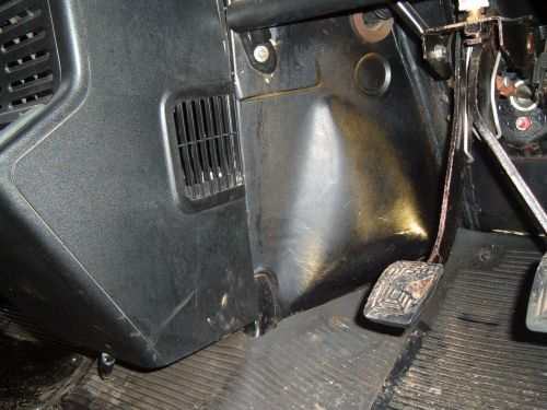

What does that part of the scuttle pressing look like from inside the car? I'm sorry to impose, but there is probably only one, maybe two GTLs in Australia. Most cars here are pre '78. I must say I have an ulterior motive, I'm wondering if I can slip a big engine in without having to modify the scuttle, so I can change it back one day if required.
Cheers
The shape of the panels is much more obvious from the inside. Looks like the shaped area on the GTL would fit neatly under the storage compartment of the L.

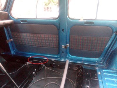

Chassis number should be stamped on crossmember where front left seat is.
Where longitudinal one meet transverse one
Picture will tell more
It should be in that red circle

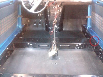

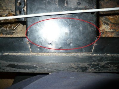

Here is picture of same place but right side. So there is no VIN number.
Hi Petak, to me that is the right side. UK car the drivers side. European car Passenger side.
Beware Simon do not take an angle grinder to the paint you wil probably remove the number.
Only now i notice i have pointed at wrong side.
VIN number should be on right side od the car. No mater if car is LHD or RHD.
Sorry for misguiding you.
Simon use sand paper and gently cross over that place.
