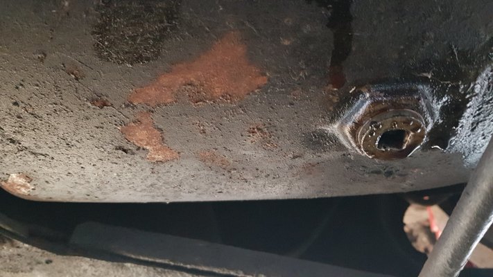

there oil all over the oil tank and its losing oil

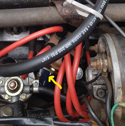

If the sump is covered with oil, wipe it clean and then see if you can spot where the oil is coming from. If you're lucky, it could be something simple like a leak from the sump plug. If your car has an oil filter, check to see if the oil is leaking from its seal with the engine. If the filter has been changed recently, it might not have been fitted/tightened correctly - they're more difficult to get to on Billancourt engines. 20210322_165435.jpg20190916_114718 (3)_LI.jpg
If you've taken the rocker cover off the top of the engine recently, have a look for leaks there.
Some photos would be really helpful.

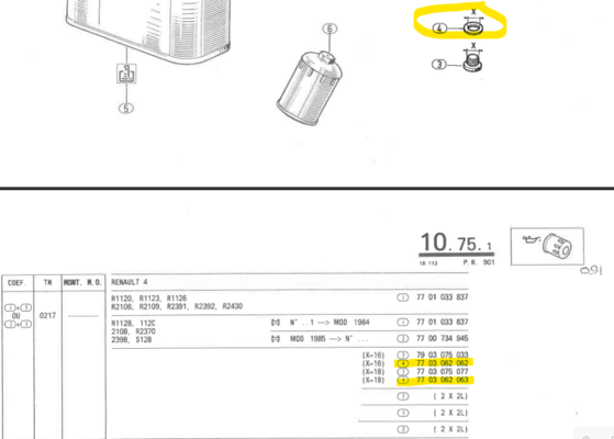

If the oil is leaking out of the "screw" in the oil tank, ( just like in Andy's photo,) you don't need a new screw.
Just the washer, which is copper.
You can see it only when you take the screw out. I have no idea what the size is, maybe someone here can tell you that.
I bought my washer from LeClerc supermarket in the Auto section. You're in France, so you must know of LeClerc? But any auto place will stock them.
Just checked, it looks like 18,3 inside diameter and 24mm outside diameter and 2mm thick.
mojobaby is correct. There is a 'sealing washer' made of copper.
According to the parts manual there are two sizes: 16mm or 18mm inner diameter.
For our GTL, the inner diameter is 16mm. The washer is about 22mm (outer diameter) and 2mm thick. The Renault part number is 77 03 062 062
Of course, you have to take out the sump plug (screw) with a 10mm square-ended tool and the engine oil will pour out. You could either carry out a complete oil change, or try to plug it while replacing the washer.
