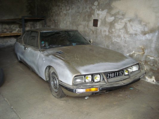

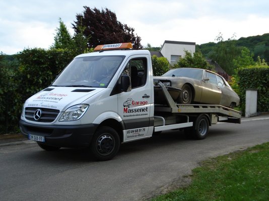

I'm Still owner of many R4, with my girlfriend we have 4: three GTL and one F4, but these last years I stopped working on them, I bought others cars for my collection: Peugeot 304, Citroën DS and the last one: a Citroën SM. Since I tasted the hydraulic suspension on the DS I knew some day I would have a SM, hydraulic suspension + V6 Maserati... waouh !

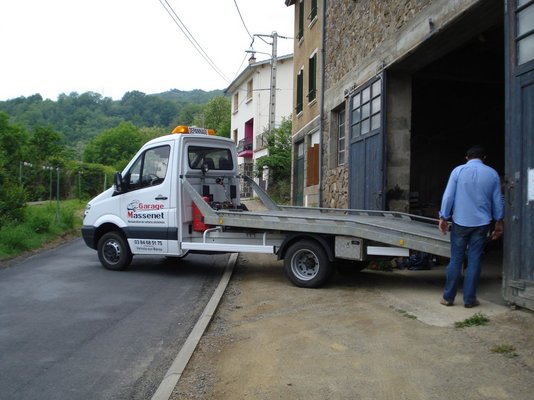

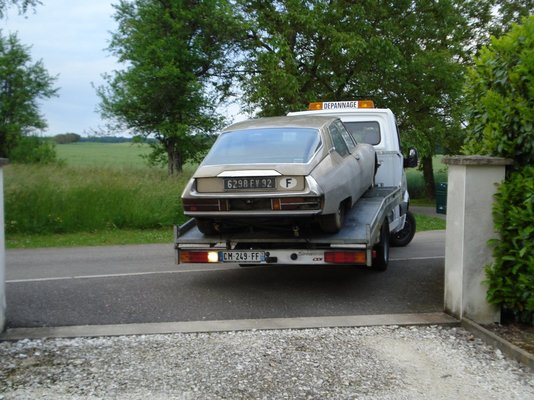

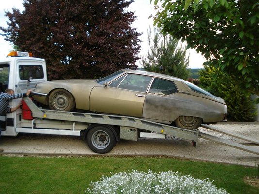

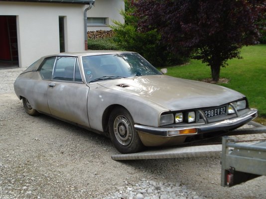

I bought it about one year ago:

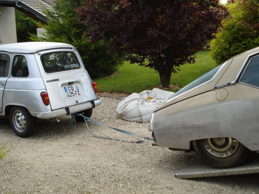

Even I knew the engine is not blocked, it didn't work at this time, I'm definitively completly mad !!!

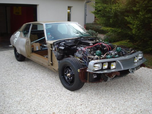

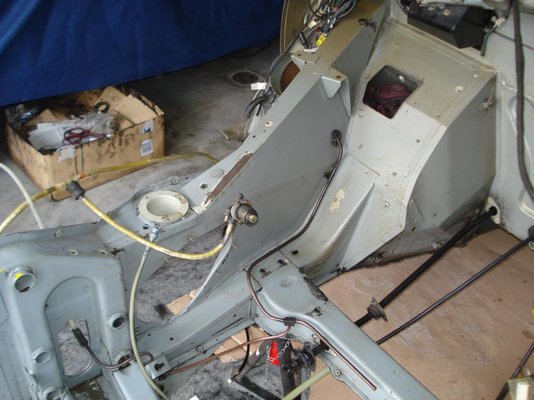

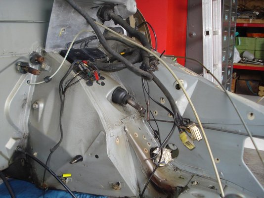

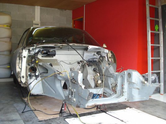

The car was parked in my garage since may, and since the beginning of december 2015 I started to dismantle the front of the car. I finally decided not to try to make the engine running, afraid of breaking parts like valves or timing chain. I don't know what maintenance has been done on the car, so I choose to be prudent.
I took about 530 photos since the beginning of disassembly, these sort of Citroëns are made with a lot of bolts, spacers, nuts, screws... it's terribly complicated for every part I want to remove.
Almost all the hydraulic hoses have been removed, it's a real labyrinth and actually I don't really if I will be able to fit them back in the car and make the system run properly...
The car is in very good condition, there is only light rust at some little places, but nothing serious, and fortunatly no rust holes anywhere. I've been heard the SM were better than the DS concerning rust, and looking at mine, it's true :)

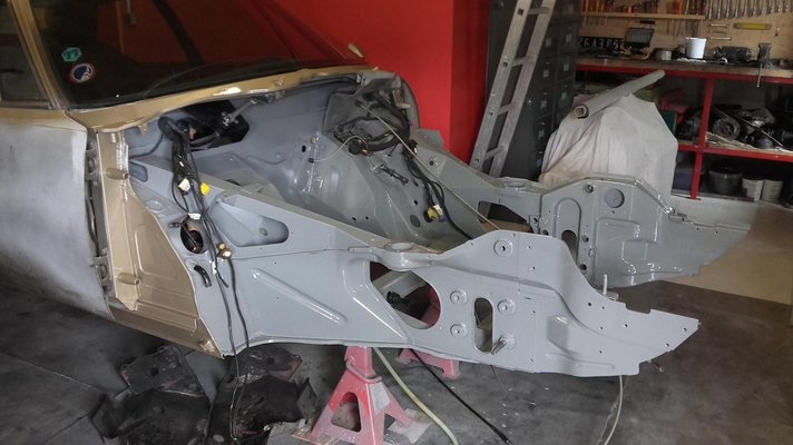

I want to remove all the hoses to have access to the front "unit" (= subframe) and side rails, then I will sand, protect and paint them with the genuine color: AC092 for the unit, and AC318 for the body.

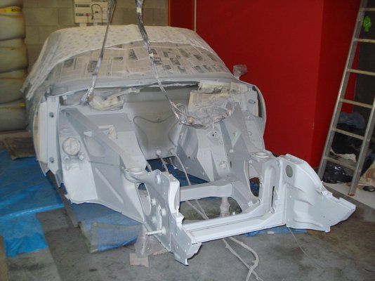

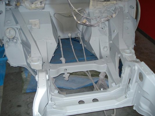

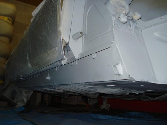

Hi, last week I applied a primer on the front of the car and the side rails, seeing the car in a clear color like that is motivating, but now I have to do the same on the rear underneath of the car...

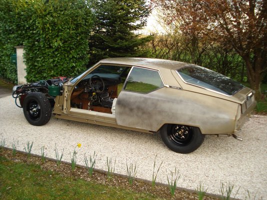

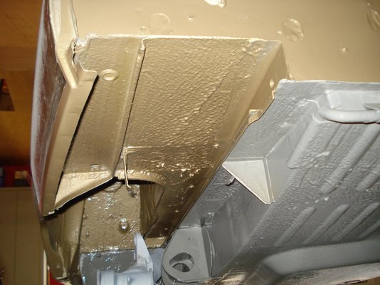

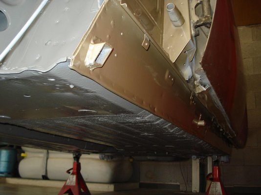

Update...

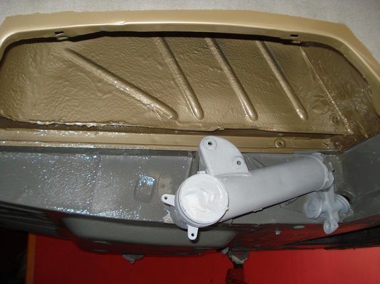

All of the underneath has been painted, with AC 092 "Gris brumaire", and AC 318 "Sable métallisé", my own paintjob is finished, the exterior of the body will be painted by a profesional.
