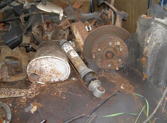

shocking news
sounds like i better dig out all the boxes of genuine shockers i have got buried
prices on ebay may suddenly rise !!
found this lonely one the other day ,will let you know what else turns up :)
paul
