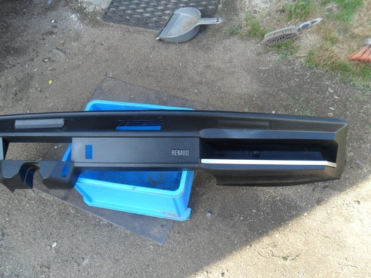

Second generation black dash, 35 euros
Deuxieme generation tableau d bord en noir 35 euros

Hi,
Not interested in buying it of you.
More in how to remove it.
I have a dashboard like yours in my Safari, and need to take it out in 1 piece.

Remove steering wheel. pull indicator and lighting stalks out, remove around 4 screws from below windscreen, remove screws visible from lower part of dash under bulkhead and the one in the glove compartment. Tug gently to identify position of screws I've missed. :)
Malcolm is right ,there is also one in the middle of the dash ,also unclip the air vents .Take your time it can be brittle.
If you do break it ,you know where to replace it !!!!!. Good luck
