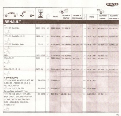

Hi,
I located different part numbers for decarbon shock absorbers for renault 4s on ebay and wondered if anyone might be able to tell me what the differences might be and which I should get for a 1983 tl with 845cc engine.
The numbers are V01191412 V01190612 priced at €114
and V01138312 V01138512 (priced at €121)
Nick

Here is what I have found.
Front goes with part no:
D2251383 - comfort
V01138312 - performance
V01191412 - performance
Rear shocks
D2251240 - comfort
V01124012 - performance
V01190612 - performance
Rear VAN (F4/F6)
D2251385 - comfort
V01138512 - performance
Here is where I have fond this numbers
http://www.delphi-dpss.com.pl/newproducts2.htm
Look at throu catalogue and you will find which one fits yours TL
Found that a while ago somewhere on this board ...
