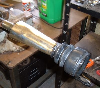

One more question has anyone replaced the rubber covers on the drive shafts themselves? I have some that are about to go but not owrn and it seems a shame to replace with new just for the sake of a couple of rubber gaiters.

Halfshaft boots are a bit fiddly, but the Haynes manusl covers them well. From memory, once the old boot is removed there is a three legged spider holding the joint together. That pings off with a screwdriver, then you need to make a cone using tin from an old oil can which is placed over the end of the driveshaft, everything is covered with oil for lubrication, then the new boot will expand enough as it goes up the cone to go around the CV joint. The Haynes manual explaians it all better than I have.
