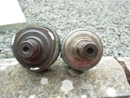

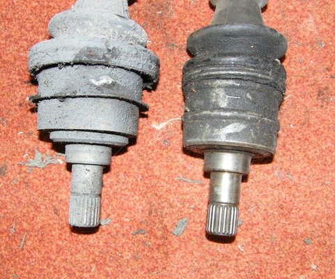

Have taken some photos of both driveshafts and highlighted wear points.
Interesting - I don't think either of them look like my GTL drive shafts, but then I have not looked at them for a long time. If they are both the same length then that is OK, and if they are not worn out then great!! You can do one of two things - fit a new inner boot, grind off the metal that's touching the diff bearing adjuster / plate seal and go your merry way. Otherwise buy a good original matched pair then you know you have the correct ones. The choice is yours but both options will work!!
I've been sorting through driveshafts today (to try to find one with a good boot) and found both types. The more common seems to be the one with the triangular end.
The shiny ring where the seal rubs seems to be in a different place on each of your driveshafts. Can't imagine why this would happen. Can you see any sort of end stop in the gearbox on the side that isn't rubbing?
It's in the same place Malcolm - look at the photo! Another answer could be that a pattern shaft was fitted at some point. A company called Supra used to supply them and the didn't always get the fitment correct.

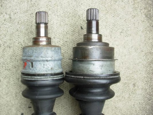

Good point - I blame the heat. Driveshafts look normal. Here's a shot of a couple of mine:
The triangular shaft has cv boots marked with Renault part numbers and the other shaft shows Glaenzer Spicer. As both oil seals seemed to have failed it makes me a bit wary about the setting of the differential caps. Just on caps, does anyone have advice on removal as I have struggled to get them to shift.
I can't think anything about why did it happen...I meet this type of driveshaft on many R4s and I have never had any problem. The smaller diameter inner CV joint is typical on GKN/Glaenzer Spicer driveshafts.
