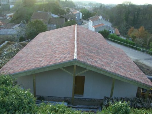

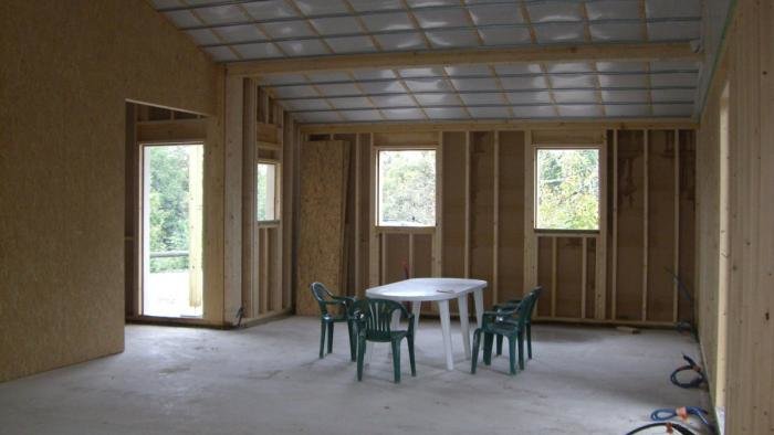

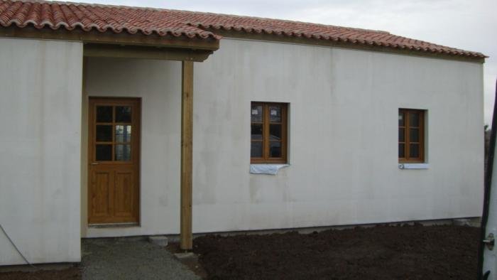

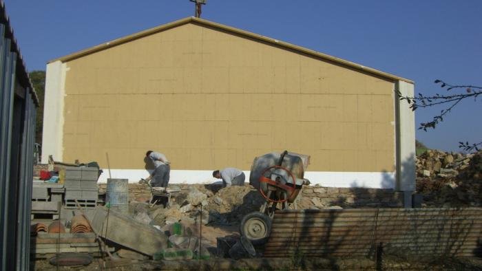

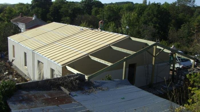

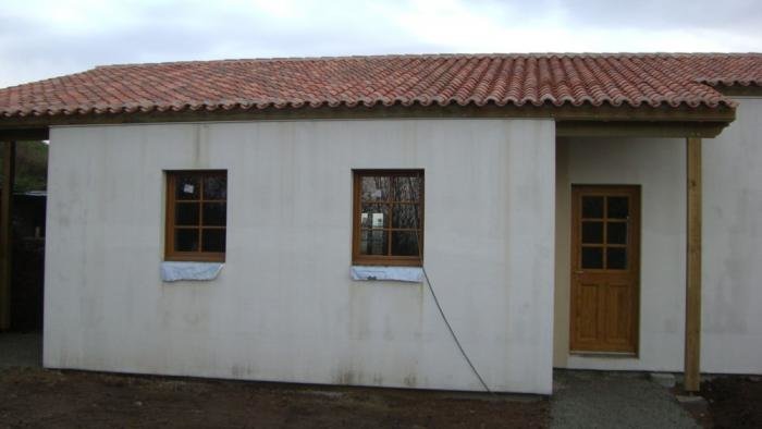

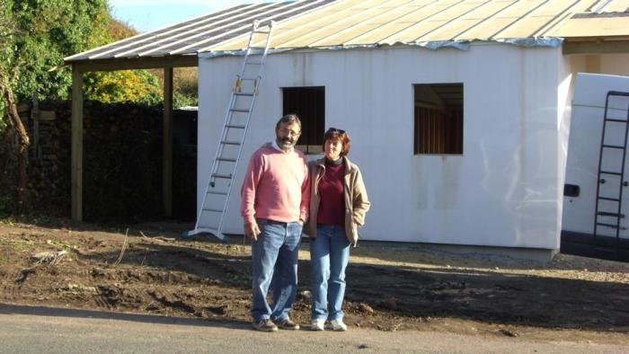

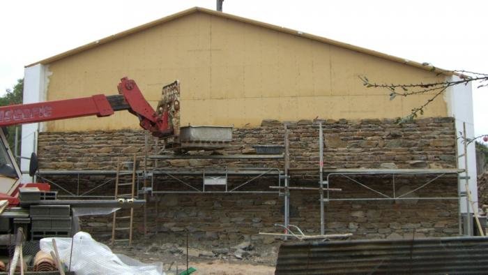

Thanks for your interest in my little project - The walls are made of 150mm studs in filled with high density 'laine de bois' - Wood Wool (made in Germany)
On the outside of the wood studs is a 50mm layer of dense fibreboard - again made in Germany. The wall will be finished with some stuff called Storender - colour to be decided.
To all intents and purposes, sadly it will look like a traditional French house but will be really well insulated - The house will be heated by this English
