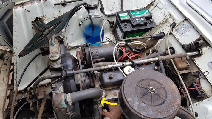

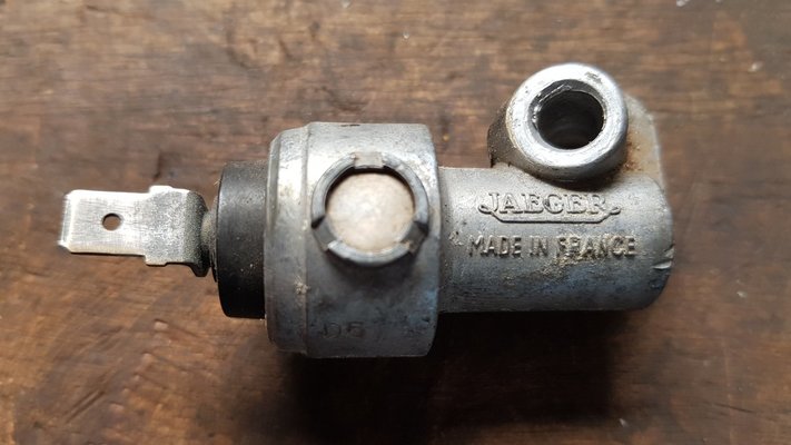

H Henri4 New Member Messages 2 Location Stafford Apr 1, 2022 #1 folks - henrietta requires a new engine coolant temperature sensor - can you help her find one? thanks henri

E edwin Enthusiast Messages 845 Location Lichfield Apr 1, 2022 #2 The water temperature sensor is in the top tube. You can get them from Fransoze, I think a 93 deg is the one for this climate.

laxeian Enthusiast Messages 529 Location Earth Apr 1, 2022 #3 Thermostat is in the top radiator tube/pipe, sensor is threaded into water pump with wire to loom, Fransoze amongst others will stock, sensor should be stamped with temperature/resistance rating req. on one of the nut faces. Termocontacto de Temperatura 115º Rosca 18x1´5 Renault Termocontacto de Temperatura 115º Rosca 18x1´5 Renault 4,5,6,7,12 y 18 piezasautosclasicos.com

Andy McGhee Enthusiast Messages 1,545 Location Cheltenham Apr 1, 2022 #4 Henri4 said: folks - henrietta requires a new engine coolant temperature sensor - can you help her find one? thanks henri Click to expand... Do you need the type in the first or second photo? You can get a secondhand one for Cléon engines (like the one in the first photo) here: Sonde indicatrice de surchauffe :: Palace de l'ancienne www.palace-de-lancienne.com ? Last edited: Apr 1, 2022
