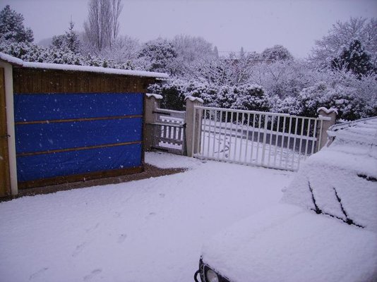

Hi, my F6 has become harder to start now the weather is colder and I just wondered if it would be wise to change to a thinner engine oil. I have 20W 50 in at the moment as I always do but was thinking of maybe putting some 10W 40 in - would this be wise or could it cause more wear on the engine.
The car is always outdoors too and it was -5 outside today :eek:.
I have also thought of changing the coil - would any 12V coil be OK to use or is there a certain spec one I should get?
Kind regards, Matt
This was on the 24th Dec

Yes, it is a bit cold here malcolm but can vary - it was -8 yesterday morning and my partner was unable to get to work because of a snowfall the night before ! In the summer though I have seen it as high as 45°c !

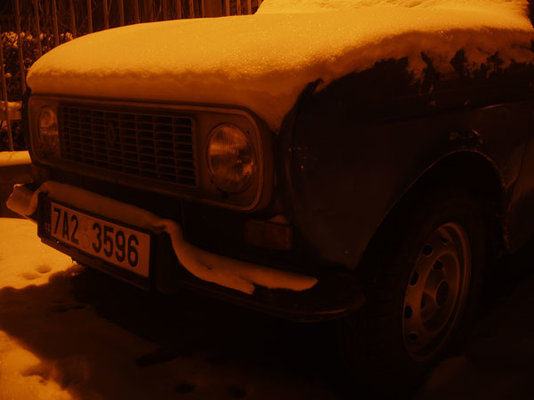

My Sunoco Oil supplier recommends use the 15W40 API SD or SF as well. I use 20W50 yearly, however, I haven´t nerve to try my R4 today. We have -12.5 °C here in Prague. Pavel

Wow, the engine started today! After one month standing in the street, today we have very rainly and 2°C. I moved it in our company work room for next performance.
