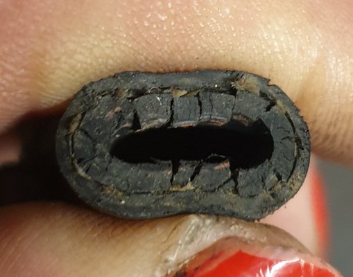

Anyone up to speed with fuel hose materials? We were told to upgrade to J30 R6 spec but I'm having to replace mine again after maybe 8 years. I don't think it's done very well. Came from the local motor factor so ought to have been reputable.
Some dissection of the pipe suggests the splitting was only at the ends where petrol won't have reached and the splits hadn't got as far as the sealing surfaces.
There seemed to be some jubilee clips securing the pipes. Oops. This might be my bad. I shall replace those with your actual fuel pipe clips and re-route the pipe to make it more accessible. Pipe maybe shrinks a bit after a time. The fuel pipe clips don't seem convincing at first but they will tighten as the pipe shrinks.
