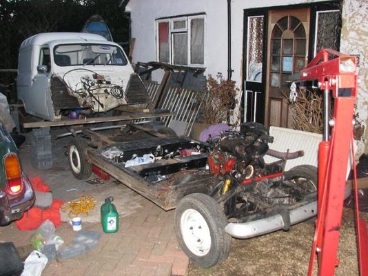

Start of project - remove body from chassis - up on wood now just need to build some supports.

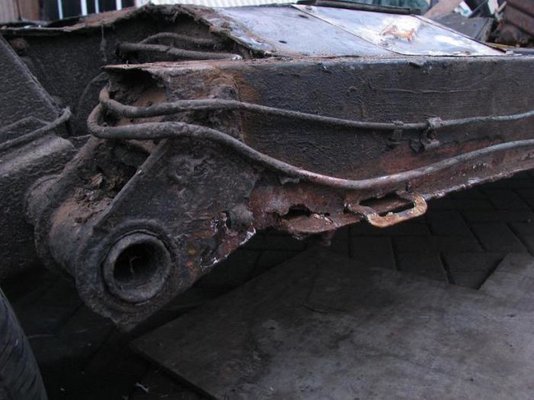

Also as you can see in this photo the rear chassis leg is twisted at the rust!

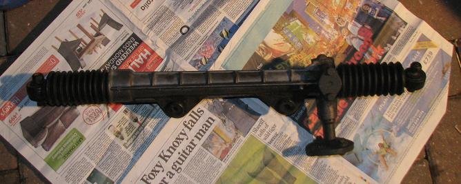

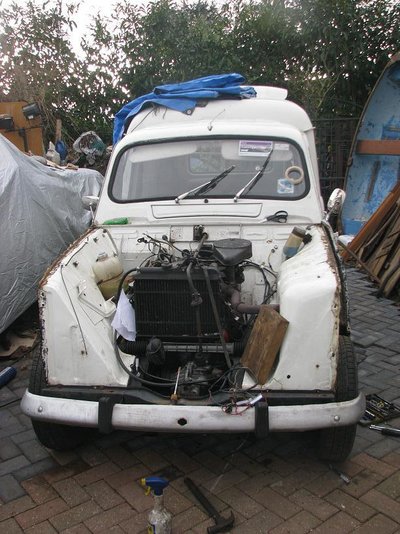

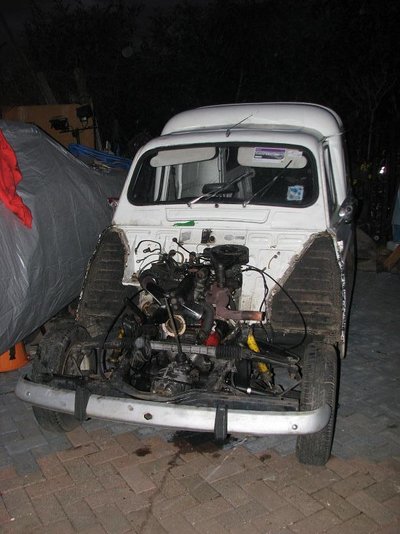

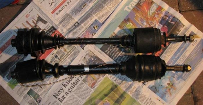

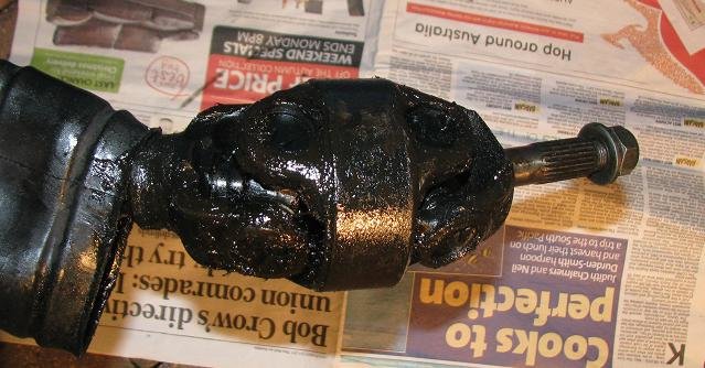

Steering rack and drive shafts removed.
I'm guessing the hardy spicers have covers to general much getting into them, should they have grease tho like one does ?
(If feels to me that this would just help dirt accumulate? although it looks nice and clean)
The side that sticks in your gearbox doesn't need grease on it. Ofcourse you can just make it a little greasy to keep it from rusting. Also, those sides are within your enginebay and not really in the position to catch a lot of mud.

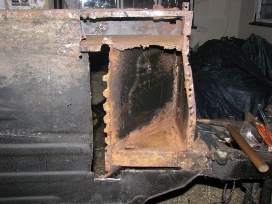

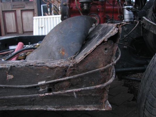

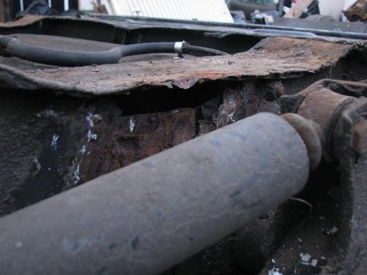

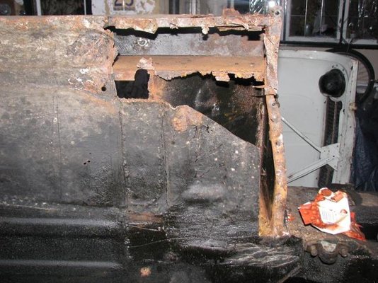

Project stalled due to cold weather now its warmer I have resumed, found a fair amount of rust!
That might prove to be a major job! But it's still pretty straightforward: cut out any bad metal and weld in new pieces! :D
Although those backbeams are really in bad shape, make sure you fixate them before starting to grind and weld...

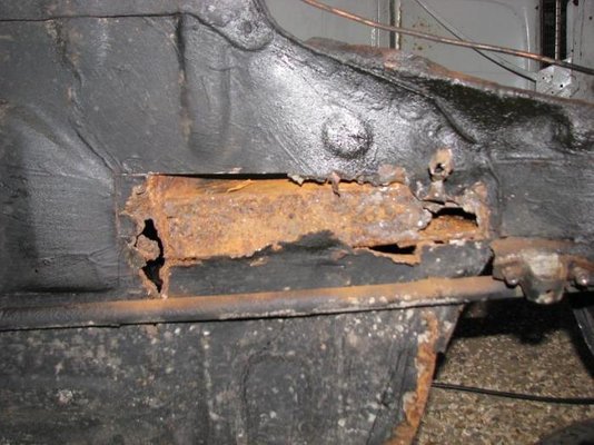

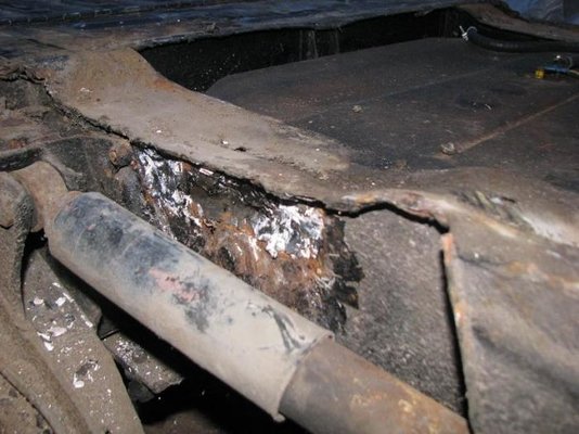

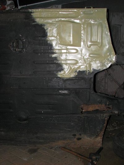

Rust hole cleaned up now to tidy the edges and fit new floor section.
Uff qui a beaucoup de travail eh.Seguro que le résultat est très bon
ce qui concerne
some amazing fabrication work in those links. I'm aiming to repair rather than replace too much.

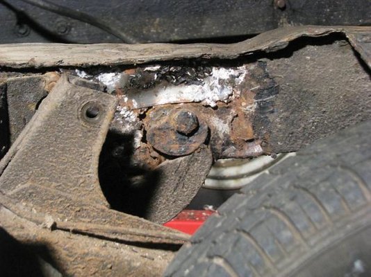

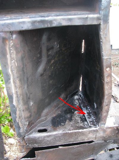

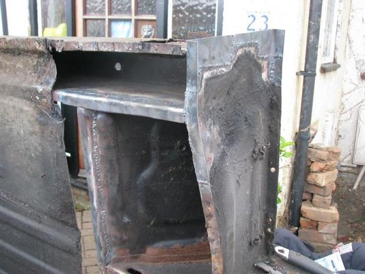

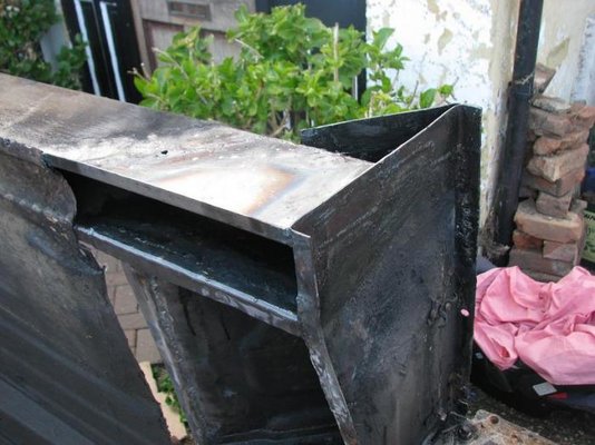

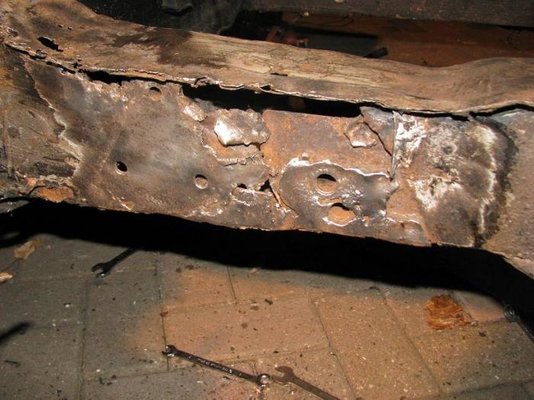

A bit more progress has occurred - discovered a horrible hole which run most the height of the front chassis member under the bit arrowed. Only way I could fix it was to cut off what remained of the rusty flange. Weld up the hole then weld a new flange on.
(The colours are all a bit odd because ive covered it in rust treatment stuff!)

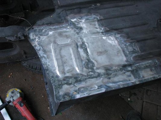

I've been a bit slow but the drivers floor is now installed :)
Sadly this 4 wont make the Kent run\1
And painted ! (A requirement in the current climate !)
